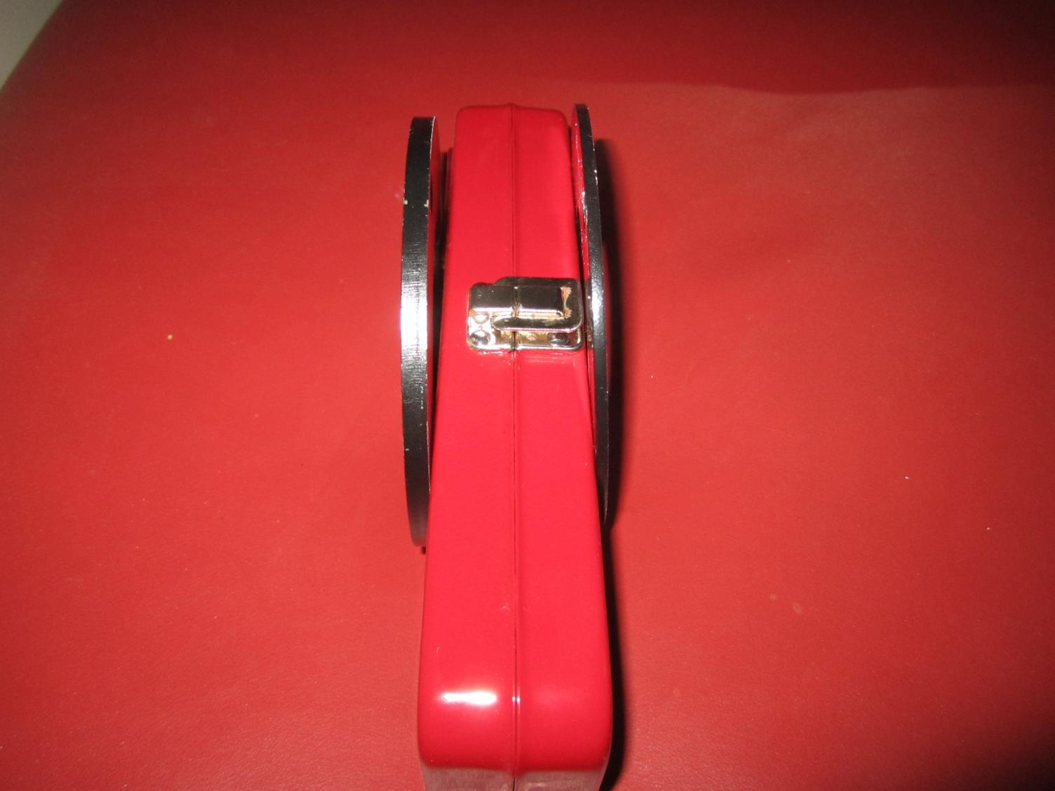

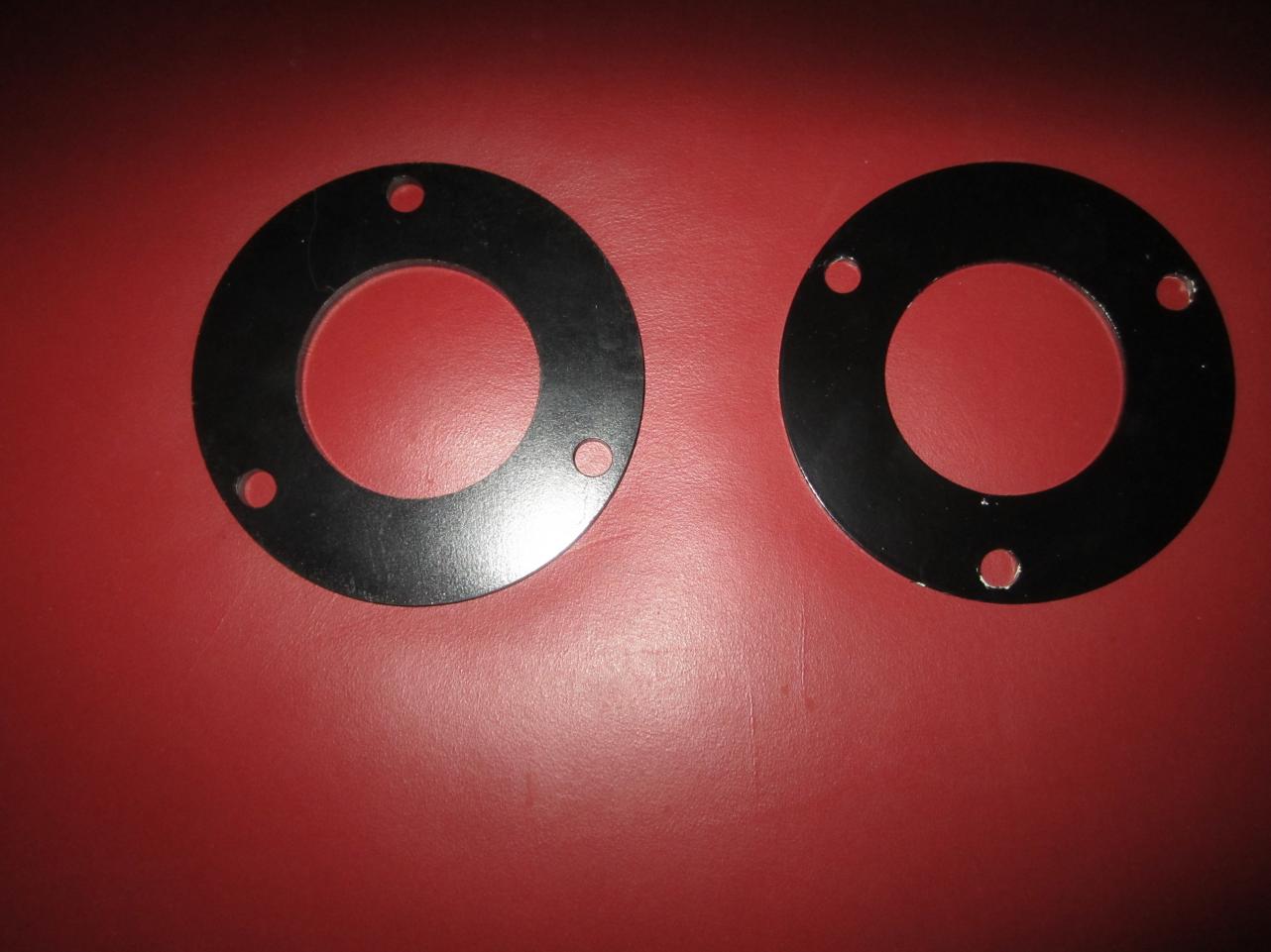

                  In regard to the lean effect when lifting the front of KDSS equipped cars, the original measurement of my front springs showed one was 10 - 11 mm longer than the other. As original it didn't appear to lean.
                  I have the Bilstein struts fitted with the drivers side circlip one slot (7mm) higher than the passenger side. The car was still leaning a small amount to the front right corner.
                  I had some 6mm spacers that I previously bought from someone here on Pradopoint (cannot recall who, but thank you) these 6mm spacers fit between the top of the strut and the strut chassis mount, the standard top hat studs are long enough to still allow a couple of threads to show. 6mm gives you roughly 10mm.
                  6mm was more than I wanted to try first up considering I had 7mm from the Bilstein's, I had a couple of 3mm spacers made up, fitted one to the front right, the car looks better and I think it's level.
                  The 3mm should technically give 5mm of lift which doesn't sound like much but it can give more as when one side or end of the car is lifted, the other will usually settle a bit too.
                  A set of wheel scales would be the next trick to check it.
                  3mm vs 6mm

                  Top view,
                  My springs were 10 - 11 mm different, ARB recommend a 10mm spacer and my (effectively) 10mm lift seems to have worked nicely.

                        I got them made up, I don't really have the specs but I will send you one you can have copied as long as you return it. PM me if you want it.
                        They're laser cut from mild steel then painted.
