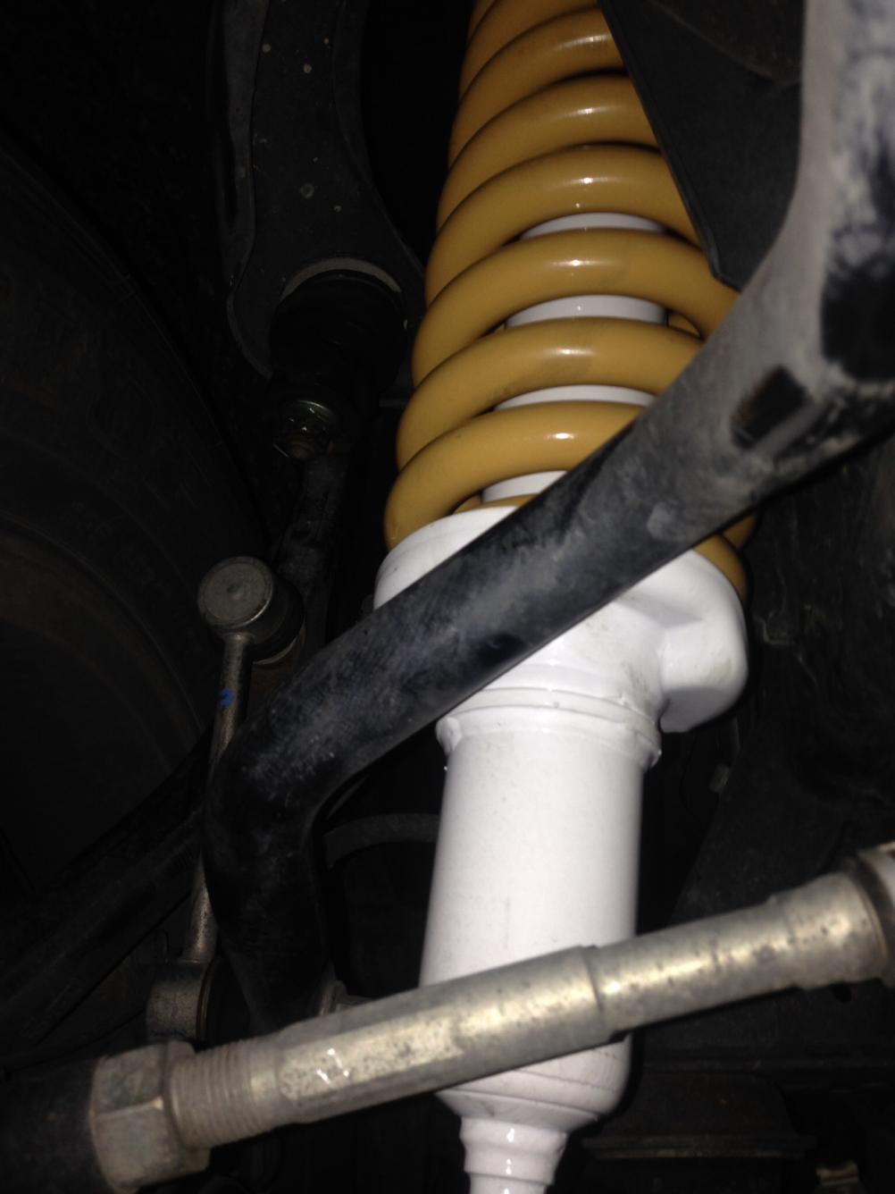

                          830mm on the front doesn't seem right, seems way to high, 60mm droop on the front is not much either.
                          • Originally posted by stephcott View Post
                            Thats Interesting, I just had a 45mm Ironman kit fitted (2013 GXL) measurements are 830mm F and 850 R with 60mm droop at front. I dont have any of the accessories fitted that you do.
                            Phil
                            Can you provide some details as 830mm at the front is too high.
                            Rim size: 17" / 18"
                            Front strut p/no:
                            Front coil p/no:
                            Photo of the coil seat.
                              Rim size: 17" / 18"
                              Front strut p/no:
                              Front coil p/no:
                              Rim size 17"
                              Front strut. 12750 GR
                              Front coil. Toyo 65C
                              2024 GXL Landcruiser Prado 250, Jayco Journey Outback
                              • Too high miss Jane. Too stiff. Without a diff drop anyway.
