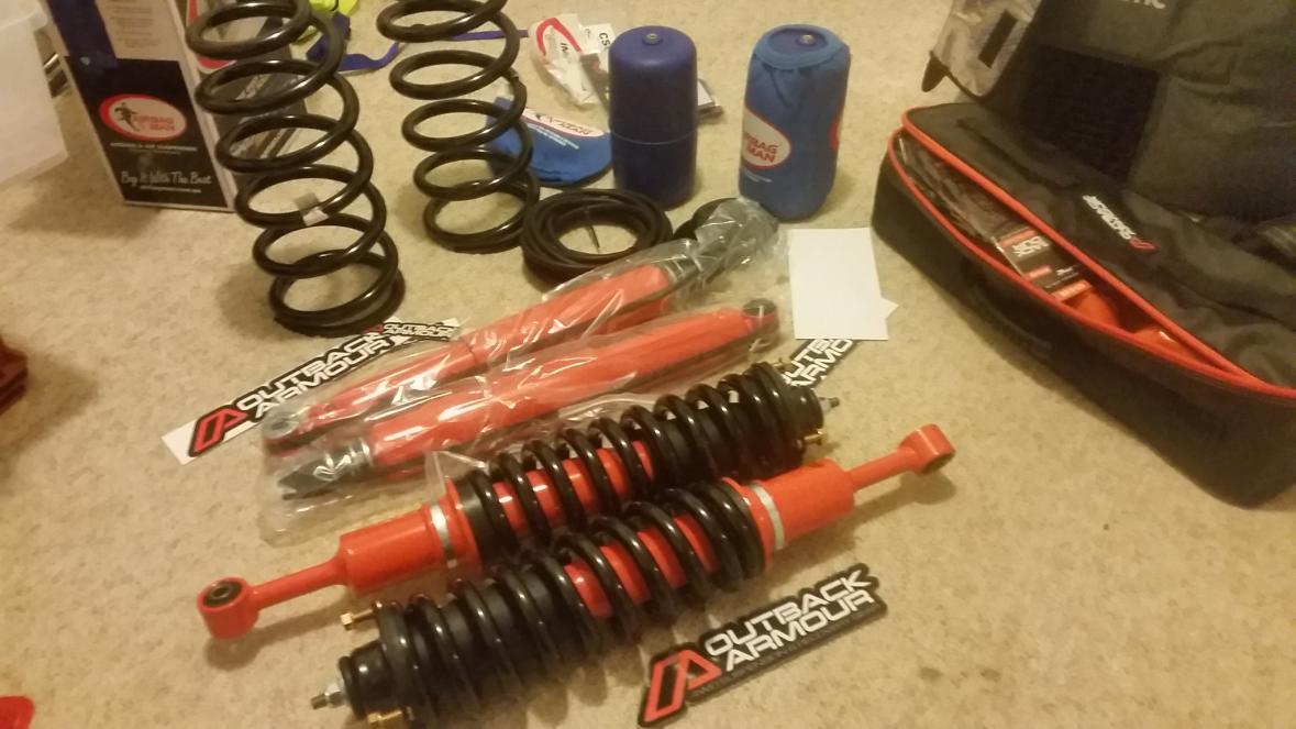

After a lot umming and aaahhhhing, i final bite the trigger, or pulled the bullet and ordered a set of outback Armour springs, struts and shocks for a 2inch lift on the gl Prado. I also grabbed a set of airbag man air assist suspension bag to help the car level out when loaded.
What i got was the Outback Armour HD front struts with spacers, and the normal duty rears.
So, after ordering from Opposite Lock in Midland, WA, they arrived yesterday and I couldn't wait to get it all home and get it all unboxed.
From first inspections it all looks great quality.
Welds are neat, the paint good and the rubbers correctly fitted and neatly installed.
The front struts, coming complete, came with different spacers to gain some additional height, albeit small and to cope with some drooping and settlement. The largest spacers was installed from the box (bonus)
The rear shocks come packaged up neatly, compressed with new washers are cable tied in. They are 60mm in width which should be good for the longer rougher roads, dispersing more heat. (or that's what i hope)

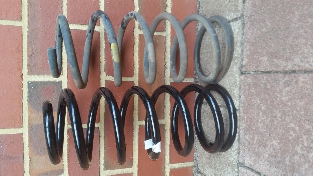

Rears springs.....well they look like springs and they appear to be very spring like......bonus.

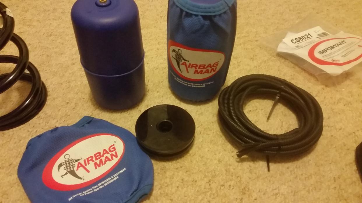

The Airbag Man suspension setup looks great.
The comes with a decent instruction manual, valves and caps, split tubing and the air line tubing already installed, two bags and i went for the Kevlar Covers. These allow for extra psi in the bag (40 > 60psi) and will add a bit of extra protection to the bags when touring.
The Kits comes with everything ready to go and should be easy to install as i'm pulling the old springs out at the same time.

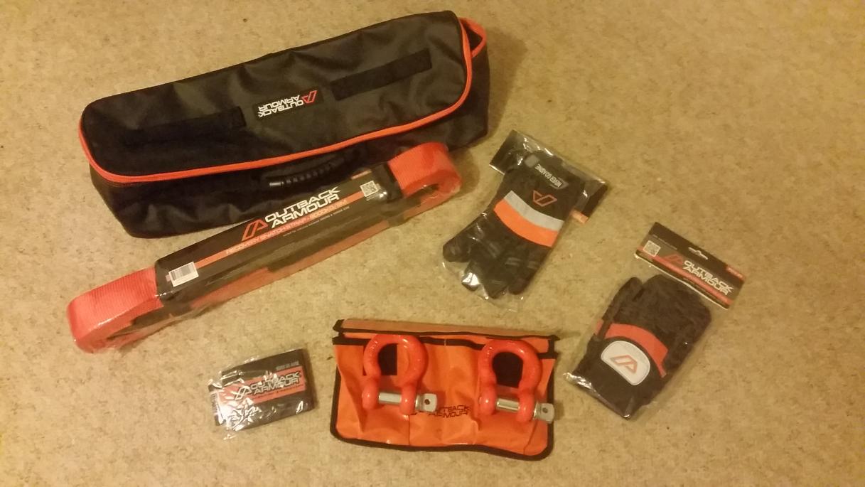

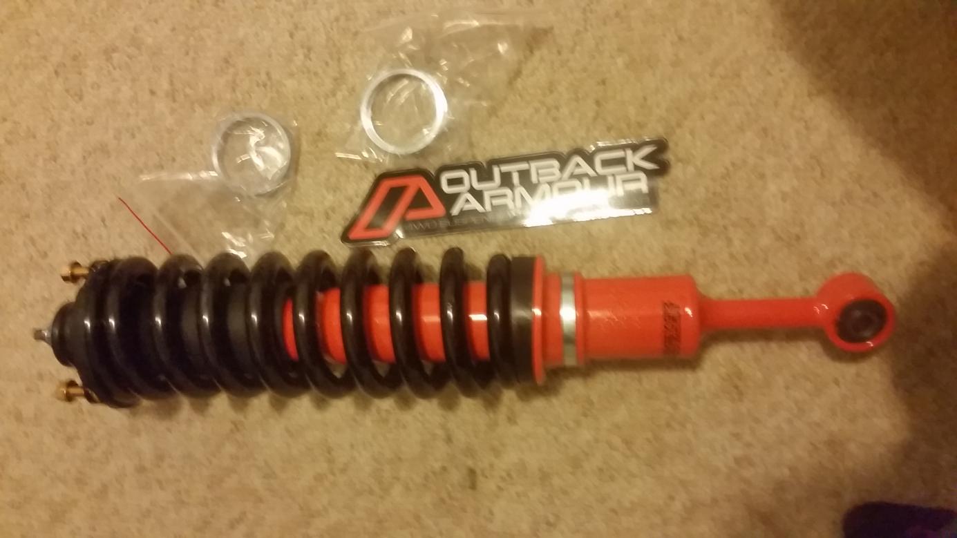

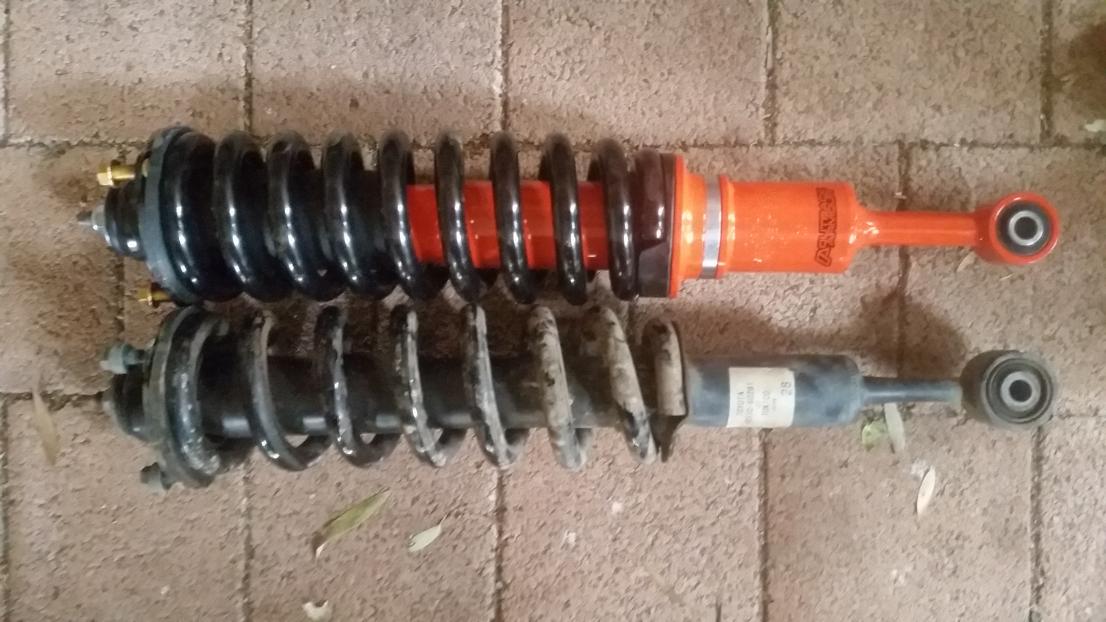

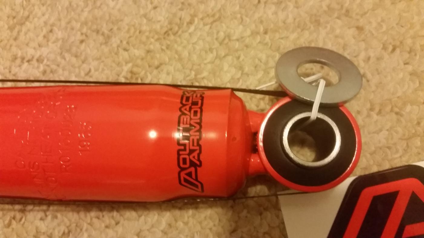

Due to the amount spent, Outback Armour through in a recovery kit for light trucks.
the Kit has two rated shackles in a bag, two sets of gloves, a snatching strap (8000kg) and most importantly, a stubbie holder. (BTW when are the they going to make these big enough to fit a wine bottle. The brown bag just doesn't cut it)
