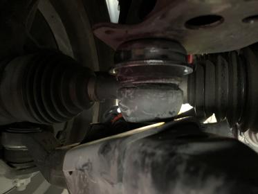

    I also installed a progressive bump stop, however, at the moment there's no gap between the bump stop and LCA on the left, but plenty of space for the one on the right, is this caused by the lean?
    Should I be worried?

    Left

    Right

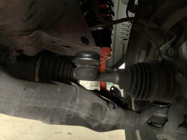

      Very good suggestion to check the spring seat, below are a few interesting photos, that might explain the lean?

ID:	751448Click image for larger version
      Any thoughts?
        Those spring seats are definitely the cause of the lean. Due to the design of the front suspension a 5 mm change in spring seat height will give a 10 mm change in ride height.
        Try measuring from the bottom of the rim through the wheel centre to the guard, it is a bit easier to be accurate and most posts on here are done that way. If your still running the 18" rims then to compare to other measurements posted here subtract 12.5mm off, my 2018 VX measured 765mm that way with the 18"s, fitting an ARB Summit bar and a Optima second battery reduced that by close to 10mm. I fitted Bilstein shocks and Dobinson C59-352 springs which gave me 820 mm which settled to 213mm, take 12.5mm off those measurements for 17" wheels.
        The only advantage I see for putting some kms on before going back is to allow it to settle and then you can be more accurate with the spring seat adjustment. Say it is still 30mm high then increase the other side by 15mm to balance it. I suggest the left side because it seems a little low to me. I would be aiming for a lower rim to guard measurement of 790mm if those shocks have the travel. Be sure to measure droop before and after any adjustments.
        Have a read of the suspension measurements sticky in this section, that should give you an indication of where you should/could be.

          Awesome info Lee, I took the car back to the workshop and showed they the difference, fitter told me this is to compensate the KDSS and all struts pre assembled, he then contacted outback armour for confirmation, and both agreed the front left is sitting too low. After rising the left spring seat, the font is now all even. There's still 10mm lean in the rear, but I think once all settled, it shouldn't be an issue. You're spot on. thanks again.
