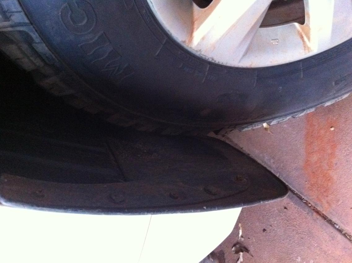

      fitted my lift kit and tyres over the weekend and they do rub, just have to sus out exactly where

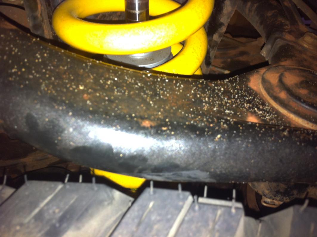

        Oh no!! That's bad news,I was talking to a wheel guy today and he told me it may hit the upper control arm when the tyre pressure is down.
          Noooooooooooo!
            I asked my tyre guy & specifically asked about the upper control arm & he said they would clear.
            Apparently he has fitted a few Prado's with 285 x 70 x17.

                    On my prado front rub on mudflaps at full lock but a little trimming will fix that.
                    Also do rub slightly on upper control arm at full lock other wise fit well.
                    I installed 1/4 inch wheel spacers which stopped rubbing on control arm but resulted in slight steering wheel wobble at speed, so i removed them.

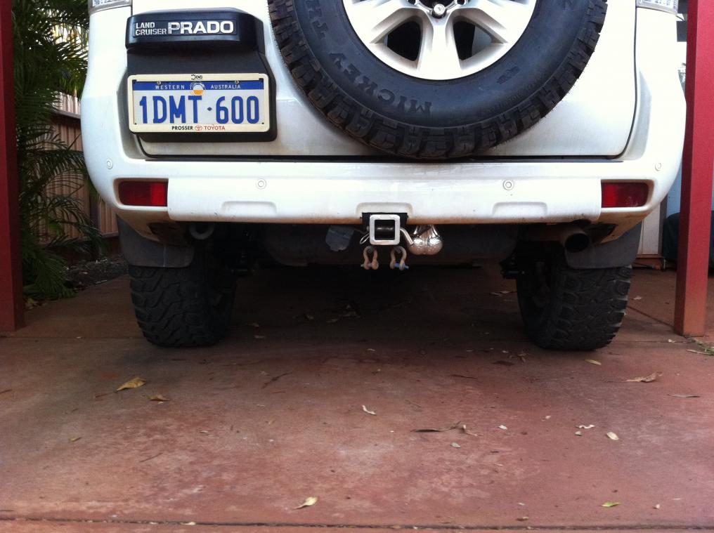

                    Different offset rims would also fix this, spare tyre was spaced out using square tubing bracket i made that goes between the door and original wheel carrier bracket, tyre has about 5mm clearance for rear bumper

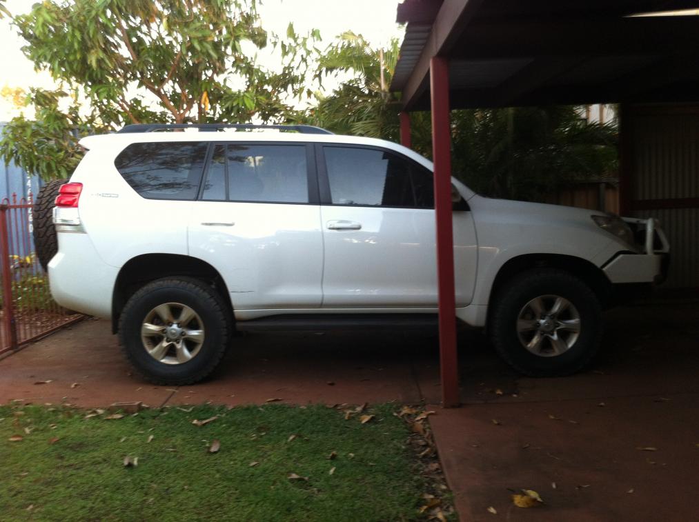

                    lift kit used was tough dog big bore nitro gas shocks and heavy duty king springs all round.
                    i am 100% happy with the lift and will sort the rubbing issue out in due time.
                    Will post some comparrison picks next to a standard prado soon,cheers
                      I'll be interested to see how you solve the uca issue with factory offset. Maybe a set of SPc uca's from the states may give a little more clearance? They have the added bonus of longer travel and more adjustment for wheel alignment.

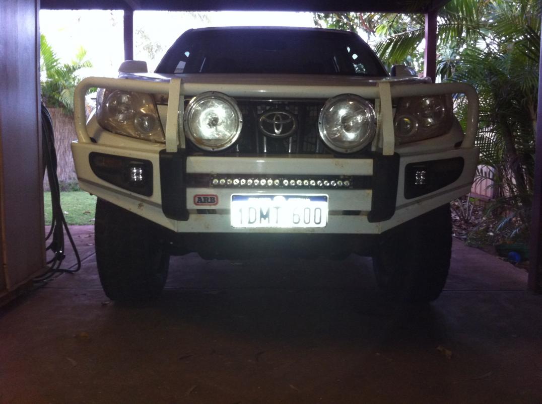

                          G'day Steelbalz, Sorry to go off topic, Can you provide some more info on your LED setup in your bar. Hard to see in your pic, but have you replaced your fogs with LED's also?

                            I have 20 inch baja designs light bar and replaced fog lights with rigid industries units.
                            Also have a pair of the new hella predators with internal ballast.
                            Will put some better photos up over the next couple of days

                              The uca is common to fj, 4runner, Tacoma, hilux and120 prado. The part number of the genuine parts is different between 120 and 150 but I have a 120 uca off a wreck and am buggered if I can tell the difference. The light racing arms have a conventional sealed ball joint which eliminates maintenance unlike other joints. The spc ones are also the cheapest I could find.
