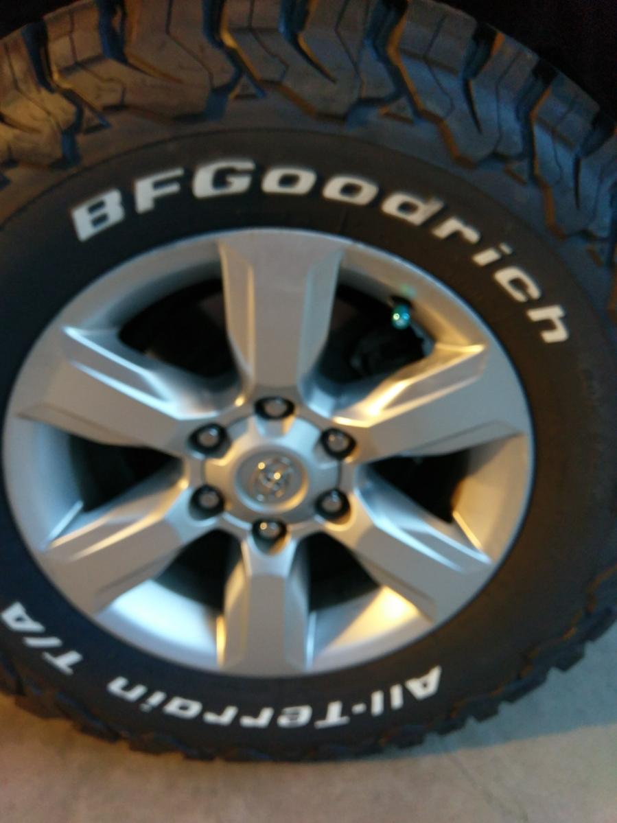

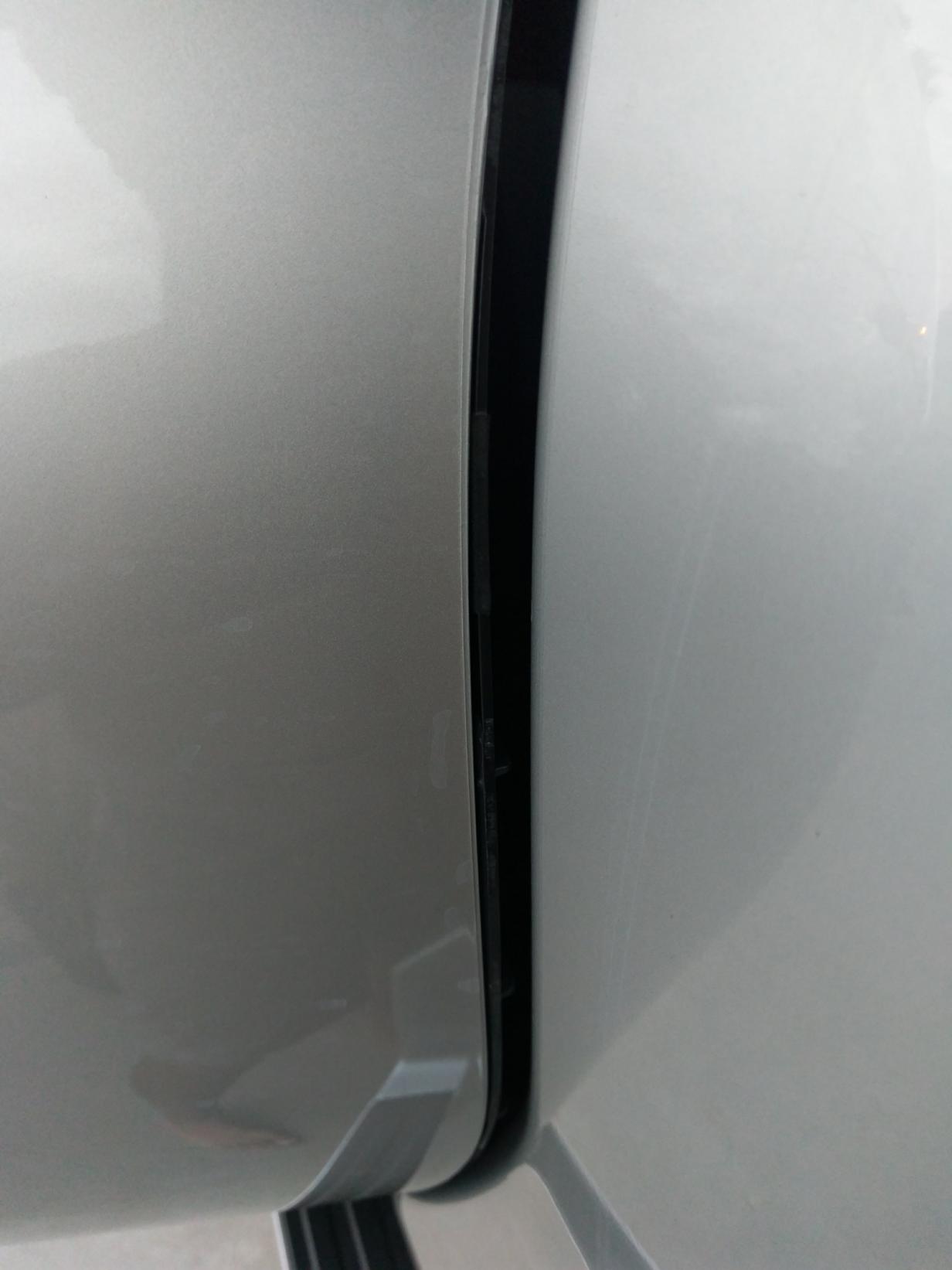

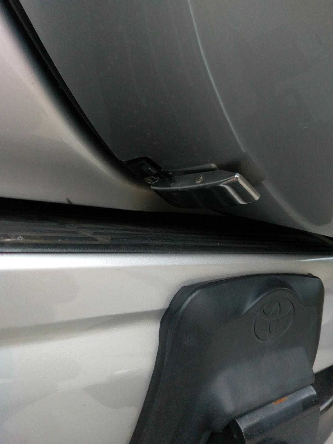

    I fitted 265/70/17 bfg's A/T K02's last week and the cover fits on the spare, no modification. Click image for larger version
ID:	656549Click image for larger version
ID:	656550Click image for larger version
    2.8L GXL Manual, ARB Deluxe bar with side rails & steps, ome suspension, ipf hid lights. bfg a/t 265/70/17
