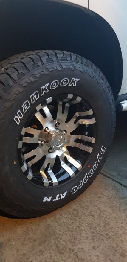

    Yep I did the same a couple of weeks ago. Went from stock tyres to 285/70/17's in the RF10 all terrains.
    Happy with them so far (only been doing highway driving). Not too much road noise and all the feedback I heard about them before buying was positive.

        That would really mess with the gearing. Just beware that it is probably illegal under ADRs if you get pulled over, or if you have a crash it will void your insurance.

          It's only a 2" diameter change from standard. It's absolutely fine and heaps of people run that size tyre on 150's. Entirely depends what state you're in as to whether it's legal or not. In VIC the only guideline is that the combined suspension and tyre lift is no more than 75mm. So a 2" lift gives you 50mm of height lift. A 2" larger diameter tyre gives you 25mm of lift meaning 75mm overall.
          Gearing change is negligible, I haven't noticed it since changing. Might be an extra 100-200rpm @ 100kmh.
          Speedo is now bang on correct, whereas it used to be 105kmh on the speedo meant I was doing 100kmh

                6.7% increase in circumference isn't a huge difference. It's a common tyre to run on the 150. Jump on the Aussie 4WD Prado 150 Facebook page and HEAPS of people are running them.
                Only scrubbing at the moment is the fronts on the mudguards - minor scrubbing when at full lock - which I'll be able to fix quite easily.
                Gearing haven't noticed any real difference - haven't run them in low range yet
                17x8 rims on a 0 offset
                Fuel increase is minimal - everyone forgets to correct their calculations for the increase in travel per rotation so they think they're using a fair bit more fuel, when in reality they're not. I.e. whatever your odometer says you've actually travelled 6.7% further.
