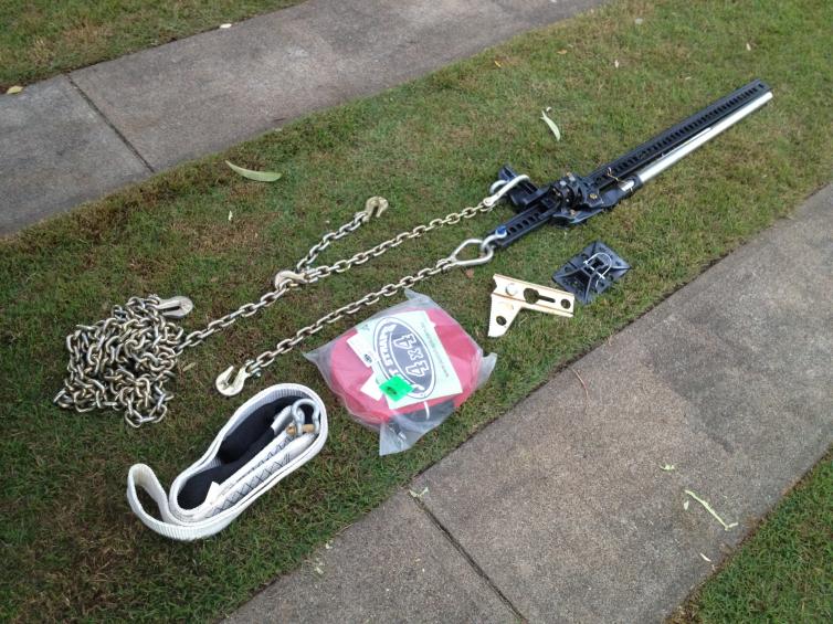

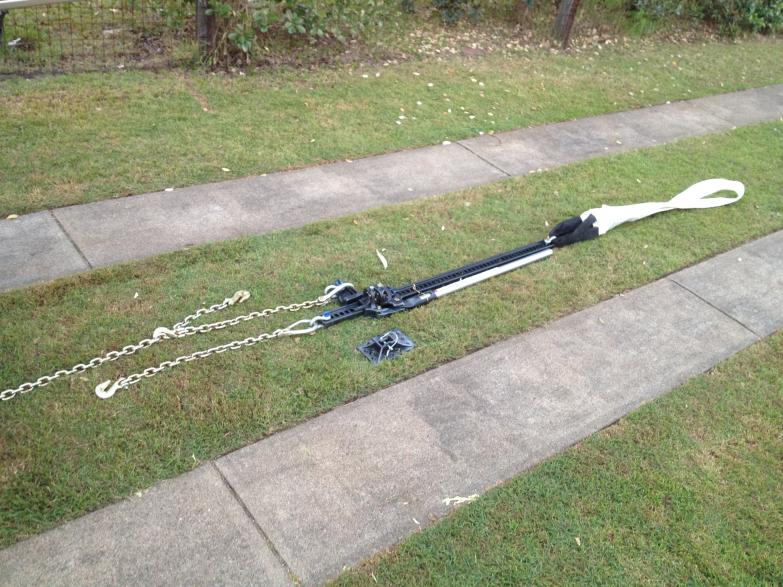

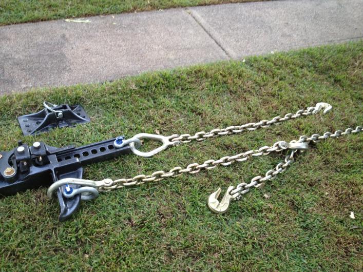

    Hi all, after deciding that winching with a hi-lift would be the best option for me I elected to make up my own kit (vs buying the $180+ genuine Hi-Lift Off Road Kit). I haven't tallied it all up, but I'd say it came in under $100 for the chain, shackles and other metal bits bought from a local lifting/rigging company, and that is for all the chain (the genuine item still requires the purchase of chain).
    Some pics attached, have tried it out and the effort is not too bad - a lot more than using an electric winch, but as I tend to avoid trouble it's the right solution for me in terms of cost, weight and versatility.
    You must be younger and fitter than I am
    The old high lift as a winch works, just its slow and bloody hard work. I will be interested to hear what you think of it after the first time you use it for real, not many people do it more than once
      Looks good mate but I think you are a bit out on your price for the genuine kit - I paid $92 plus postage. I haven't used my kit yet but as Andrew says, if I do it will probably be the first and last time
      I have used the tree trunk protector and bow shackles from the kit though
        looks pretty good man, but like already stated its blody hard work, winched myself out of a mud hole with a turfer block and then set about modifying by bullbar to accept a winch
          Let us know how you go the first time you get stuck

              yeah yeah... I know it's not much fun to use in ernest!
              I did trial 'recover' the car up a hill, biggest worry was that, with noone at the wheel, if something came undone it would head back down the hill rapidly.
              But not long after that it got some use in a real situation, the neighbor rolled his tractor and I came across him with his foot (only, thankfully) stuck under it. Was able to winch it back over onto it's wheels, the hardest bit being running from the car with 25kg of steel chain and jack - adrenalin only gets you so far! Very glad I had it on that day.
