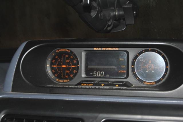

    I have the Landcruiser Prado KZJ 90 with additional instrumetns on the dashboard
    Problem is , the Altimeter is always at - 500 meter
    in the 50 m dept. and 200 m dept. also the barometer is not working
    what can I do ?
    is it possible to make a repair ?
    perhaps somebody knows a solution .
    It is not necessary for live , but it looks better when it is working well
    Thanks forwards
    by the way, we got the first snow today , arr. 15 cm !!!
    best cruiser regards
    Gerhard
    Hello friends
    I found the solution for this problem
    open the instument and remove the metalcover plate , loose the electrical wire, than you see the mainboard , than blow with airpressure ( not so strong) over the panel , in all parts and corners . than you can fix the electrical wire again and switch on you car , than you see the instruments under light and the Barometer and Altimeter shows you the right terms again.
