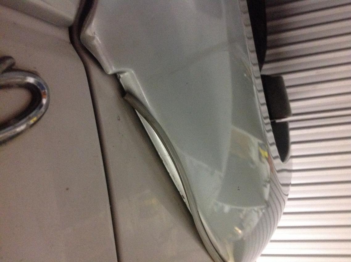

    I need to tighten up the passenger side flare on the guard as the thin rubber between the flare and the guard itself, keeps coming loose.
    When i push it back in, i noticed the flare is a little loose, thus enabling the rubber to keep falling out.
    I could not see how the flares are fitted to the body, to see if i could tighten it up a bit. How are the flares fitted on?

    I've got the same issue driver's side. Photos in this thread. http://www.pradopoint.com/showthread...g-Front-flares
    You'll see the clips holding the flare on. Theres' 4 or 5 from memory. If you notice the tab to the left of my fingers, that should bolt onto the body. Mine is broken.
    Toyota spares sell the clips and the flares if its broken.

      Does this refer to a 90 series or 120?
      The link you posted was in the 120 series, unless they are unchanged
      mine just looks a little loose at the top, and allows the rubber to keep falling out.
