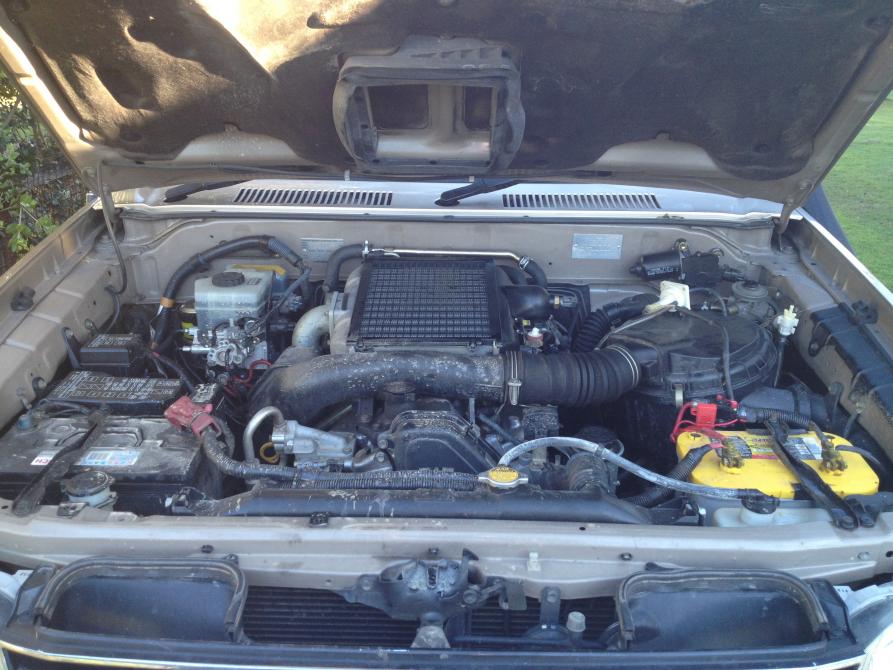

    Hi all,
    I’m in the phase of installing a winch in my 90 series and in order to power that up, I’m looking to install a 2nd dedicated battery, which is going to sit in its own battery box/tray. That I need to build.
    I have space in the engine bay and would like to the 2nd power pack there, need suggestions and ways of putting up one. Pictures will definitely help!
    I run a 1KZ-TE & am installing an 80series Aisin 1000 winch.
    Thanks,
    Sam

    If you have the 1KZ the empty space in the engine bay will fit the battery tray and clamp from a V6 prado, they have the battery on that side. Go for some aftermarket thing if that's your bag, otherwise the factory one on the passenger side is as good as... well, the one on the drivers side. Should be had for around $10 from the wreckers. Pic below for eg.
    EDIT: assuming the Pakistan spec prado is the same as Aust, which may not be the case.
      All Rounder fro cranking and the Amp Tech for accessories. Ctek 250 Dual for the unit in between.

      Jeez there's a lot of empty space in there John...
