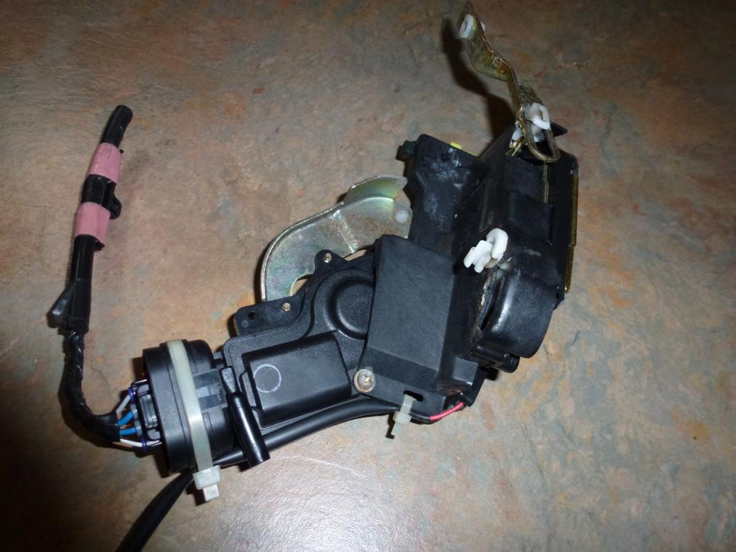

            I went to a wrecker and got a new actuator. Installed it today and all working fine. For future reference, this is a pic of the actuator. Doesn't look like the motor items displayed from Ebay ??

              That looks identical to the one I pulled out of my car - the part on the LHS of the image is the actuator, the other part is the door latch mechanism. There are three small screws holding the actuator part onto the door latch mechanism - once you separate them (note where the actuator arm connects into the linkages and be careful to manoeuvre it out carefully so you don't break anything), you can pry open the actuator and the motor is inside along with a couple of gears etc. You can just pull the motor out, slide the worm-gear off the shaft and then slip the worm gear onto the new Ebay motor which just goes straight in - just like it was made for it!
              I've read of some people having trouble with the "clam shells" (actuator casing) coming apart when the actuator actuates so I put a couple of spots of Selleys plastic glue (available from Bunnings) on it before clipping it back together (I only put a couple of spots in case I need to get in there again).

                Thanks tim_c, that explains it. I should have pulled it apart further !!
