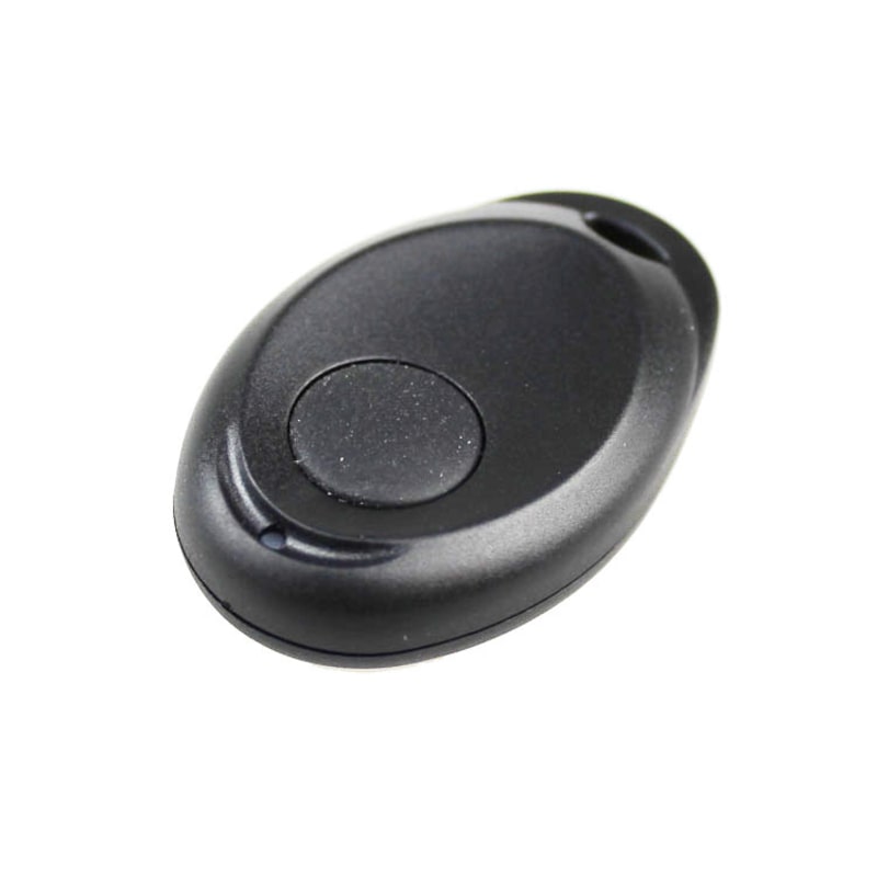

        The remotes I had were tear drop shaped with only one button. I'll put a picture below in the post.
        The original Toyota kit I installed came with the Wireless Receiver and two remote fobs and the instructions for programming them to the vehicle. Mine was a GXL, so if your's is the same or higher spec, thats all you need.
        From a hardware perspective it was simply plug and play.

          My remotes were a different shape. I found a picture (below).
          My Prado is a VX Grande. I'm not sure if they just changed the fobs or the entire unit at some point after mine.
