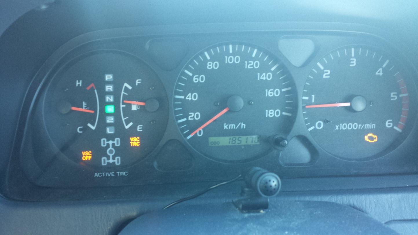

    I have attached a picture of the dash lights when it happens. Click image for larger version
