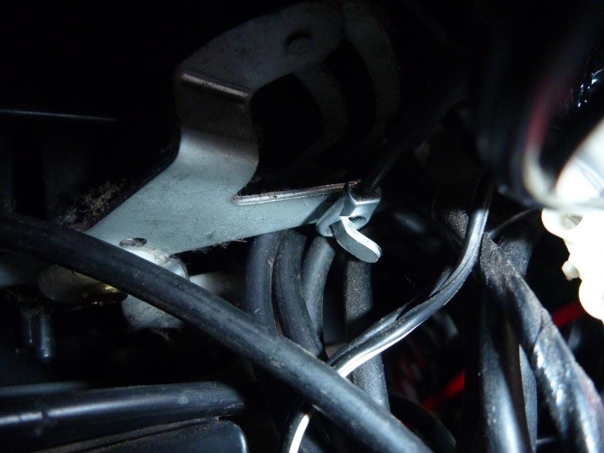

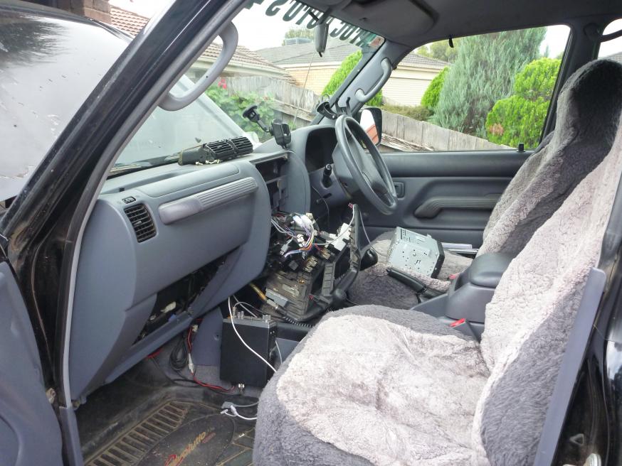

              Well got home pulled dash apart (which now I know I didnt need to do but oh well) and found a little connector had been disconnected from the flap that #### was talking about. I think the guys that put my unichip in have knocked it off during there install. So at least its fixed but I think i have just wasted $120 on new aircon gas I put in just before easter. I thought it was getting warmer in the cab cause of no gas but the flap was slightly ajar and when I used the heater on the weekend the wire was able to push the flap full open but not bring the flap back to closed again.
              Thanks for all your help guys. I will put some photos up soon.

                  Hey ####, Yeah thanks for all the help it was exactly as you described. Hooked it back up as the photo shows and sure enough heater works and more importantly so does the cold setting. And I do have to say I think the regas has helped with the chill factor.
                  So overall happy it was an easy fix. It will be good to catch up next Friday.

                    I was actually going to say the cable might have come off the flap arm. But left it a bit more open, hard to say without seeing it, being that hot it was clear the flap was wide open to the heater core. usually it will feel a bit lighter to twist if the cable is off, and you won't hear the usual clunk at each end.
