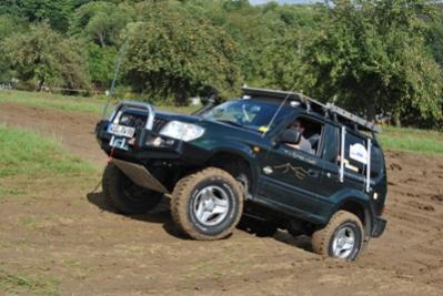

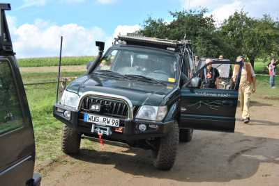

    Hello Landcruiser friends
    I am from Germany and we like to drive LandCruisers very much.
    I like to show you my new styled Prado .
    After a crash with a deer I replaced the front bumper to a steel front with a 5,40 ton winch.
    Now we are better prepared to go in offroad areas .
    keep on offroading
    best regards
    Gerhard
