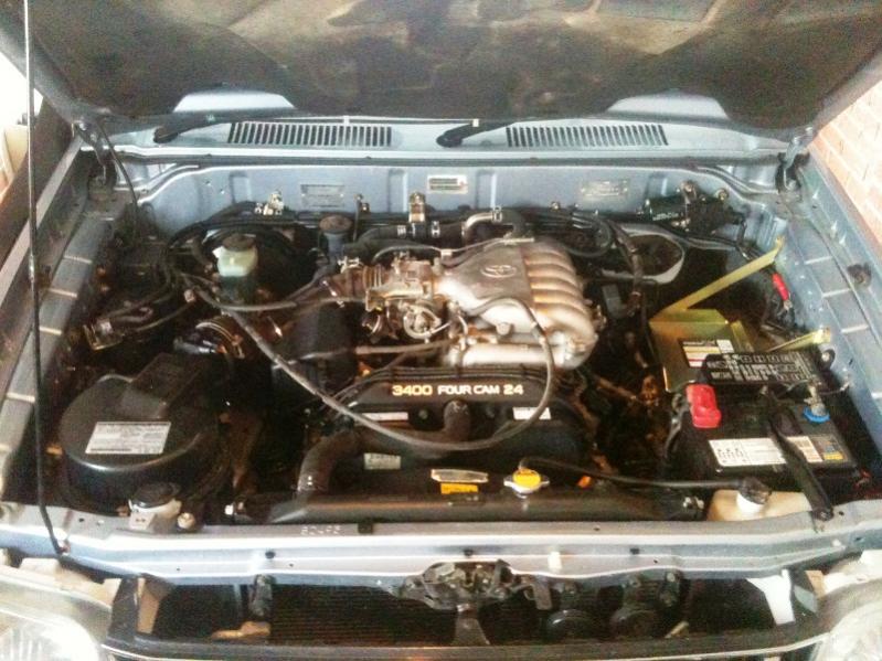

                              I'll post this here for anyone else looking to fit the 2nd battery to this model. Turned out pretty simple, just had to buy a few meters of vacuum hose and tap a new hole to mount the charcoal canister properly. I think all up it took about 2 hours.
