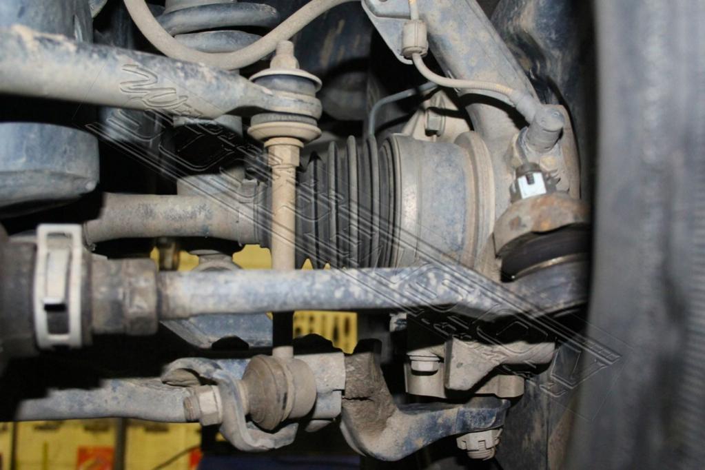

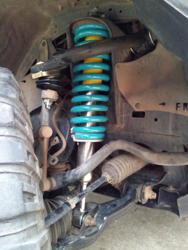

                              Hi Mark, the easiest way to explain the difference in the 2 models is with a couple of pics.....
                              The 95 Series runs the Swaybar link on the lower arm, so when it's raised the Swaybar is pushed further downward and puts the link pins under more stress.

                              The 120 Series swaybar link attaches to the upright in the hub.
                              Yes it also moves downward when you raise the vehicle, but the 120 series isn't really affected anywhere as much when you raise the vehicle as the 95's are.

                              The links i run are extended by 30mm front and rear on the 95 Series.

                              • #30
                                Hey Jason,
                                Thanks for those images, very informative! ...and what a difference between the 90 and the 120! ...and I understand now why the 90 links would need to be lengthened.
                                Very interesting change in geometry!
                                ...so the sway bar on the IFS in the 90 would definitely be more limiting in articulation travel, so maybe what MJ observed with his original measurements were correct, and the benefits of running without a sway bar on the 120 are minimal compared to the 90???
