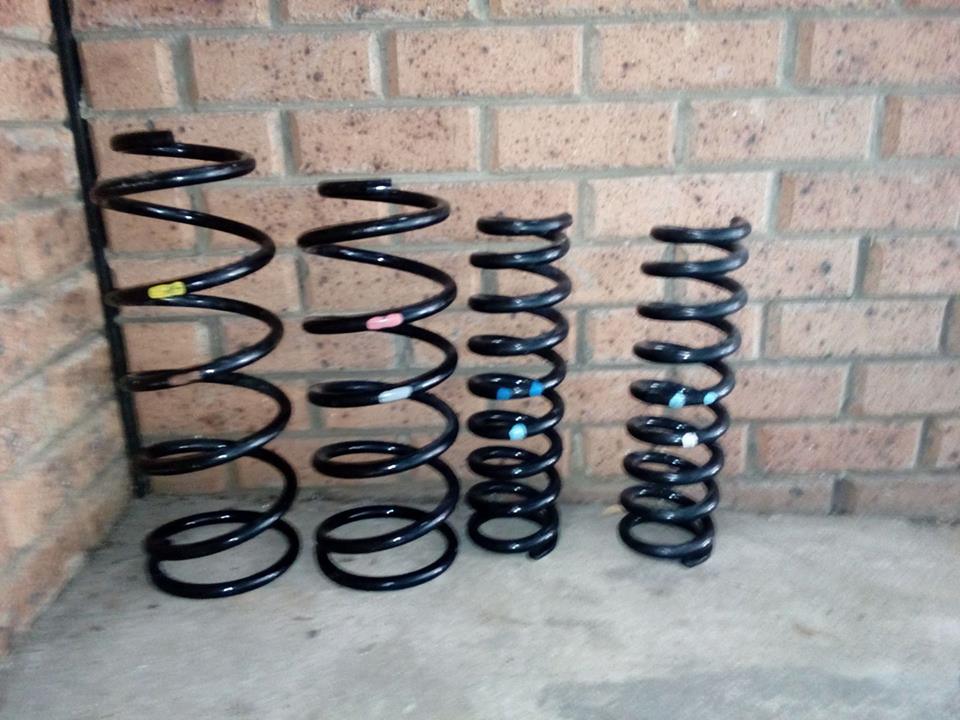

what are these springs
  • what are these springs
    Can anyone tell me about these I was told that they where 2inches and that they are extra heavy duty and they are for a toyota prado 99Click image for larger version
    If I had to guess I would say stock springs from a 150VX with kdss.
      so what would that do would that give me the lift in the 90 series or is it a waste of time ? i got told they where for a 90 series
        mjrandom is quite possibly right. Whitey will be able to confirm the coloured dots. If confirmed to be 150 springs, they won't fit on the 90. They are also uneven length, so definitely won't fit unless you are after a lean in your ride.
          Andrew wasnt there a photo of stock kdss springs a year or so back? Vague memories during the kdss lean discussions. You and whitey are the two who would know. Regardless I cannot see what use these would be on a 90.
            This is the closest thread I could find but no 90 series data http://www.pradopoint.com.au/showthr...a-4wd-vehicles
            This one has 90 series OEM spring measurements http://www.pradopoint.com.au/showthr...g-measurements
              This is what I remember but photostuffit has taken the pics away. Mentions pretty colours...
              http://www.pradopoint.com.au/showthr...ar-Springs-NEW
                I've put the pics back.
                  I am at the beach and pics don't want to load.
                  Q1: are they the same as above?
                  Q2: how did you do that?
                    1. No
                    2. Google has a cache of the photos but in low res
                      Can see now, look raised. Still reckon off a kdss VX. Just longerer.
                        will they fit or no
                          I would say no. You do not need different lengths on a 90. Here anyway.
                            i took them to toyota and they say they arent a genuine spring because all there springs have part numbers on them i figured i might try the rear seeing that is easy to pull in and out and see what the outcome is
                              The springs are different, the car will lean to one side. Springs are cheap... get the right ones.
