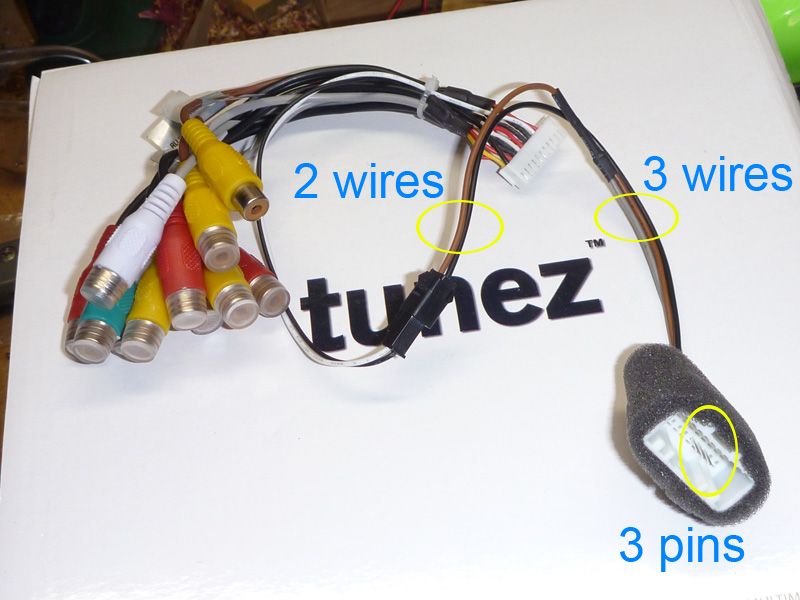

        I think you might be on to something re the two separate pins though & had a closer look at the wiring diagram. Seems that the Mode button is on it's own essentially shorting SW2 to Ground. I noticed on the wiring loom that came with my head unit that although there are three pins, matching the three on the car side of the loom, the two signal wires join together to go into the back of the head unit:
        (see photo)
        I think this is the problem & suspect:
        (1) the loom is wrong & these two wires should connect separately to the head unit so that the two similar signals can be detected separately
        (2) the head unit only has two SWC inputs being Signal & Ground which is why the two signal wires join together.
        Unfortunately I didn't check the plug into the head unit to see whether there is a connection that for some reason isn't being used.
        I'll persevere with my seller & advise progress but in the meantime if anyone has any other ideas please post.
        Craig

              • Same process they told me Rabs - doesn't work in any button order, at least on units where the three SWC wires join into two, as the same resistance value is supplied to the head unit by Mode and Seek+ as mentioned in prior posts & the head unit can't therefore tell the difference between the buttons.
                I looked at pictures of some different models on EBay & some show all three wires going into the head unit whereas the one I bought has only the two.
                Craig

                  • OK so I emailed the seller & explained why the three-wire-into-two-wire cannot possibly work.
                    I've now received a new wiring harness which passes all 3 SWC wires through to the head unit - all good & working.
                    I didn't get a chance to try adding the resistor as suggested in an earlier post.
                    Craig
