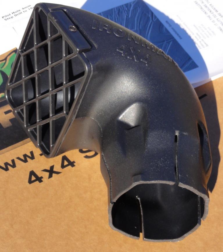

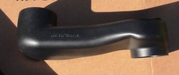

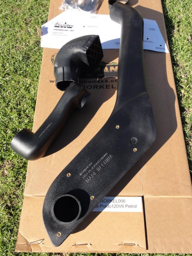

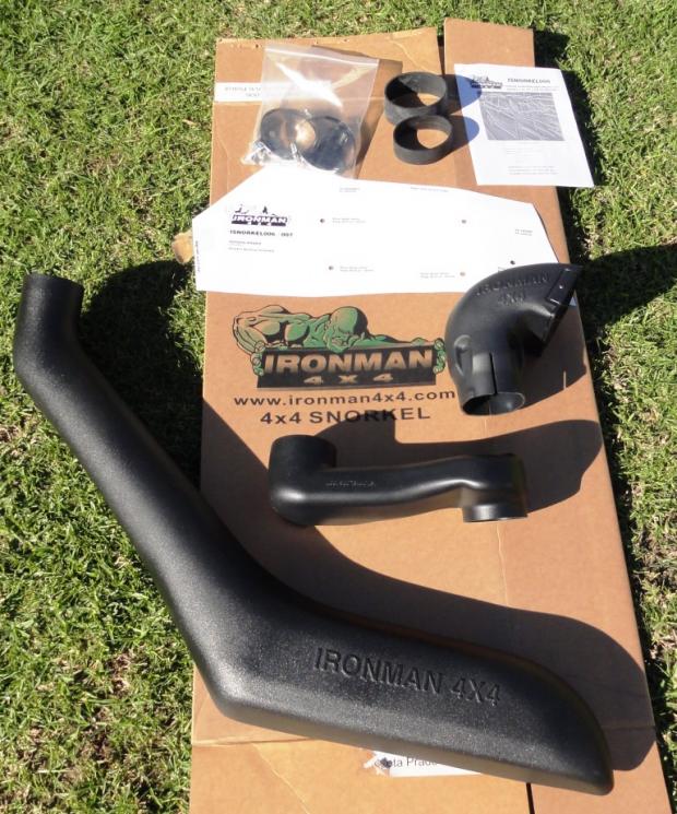

                              Hi guys I have just fitted a new ironman snorkel to my 2003 Grande Prado over the weekend and thought I would share me experiences with you all.
                              In my opinion the quality of the ironman snorkel is extremely good, much better than I was expecting. It is also much thicker and heavier than expected; the snorkel is at least 5-6mm thick and feels very solid. I think that if you were to break this than there would be a lot more damage to your car to worry about than just the snorkel.
                              The fit of the snorkel to the car was very good with no gaps when everything was done up. Being a cheaper snorkel I thought that it might be restrictive to the air flow, but I having had a good look over it I don’t think this is the case. It is of a large free flowing design. The piece that goes in the inner guard which connects the snorkel to the pre spinner is also as large as possible and free flowing with gentle curves to aid in good air flow.
                              The only thing that I would say let the kit down a little was the template was not very accurate. It still worked fine but the location of some of the mounting holes was a little out. I guess this is why they say to drill 16mm holes when the studs are only 6mm and to use the large washers which are supplied. In reality this not a problem as the snorkel body fully covers all the holes.
