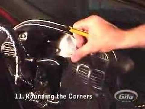

              Big-Trev, Good on ya for giving it a go. Never tried it my self but have a look at the video below if you haven't seen it already.
              http://www.youtube.com/watch?v=StFgjOD-3sM
