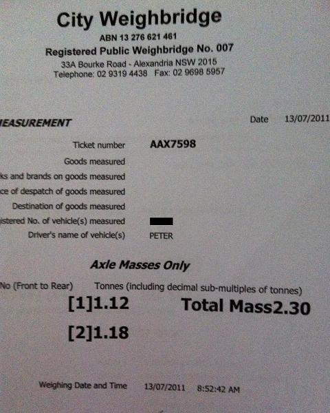

                  What's the GVM of a Hilux? The 120 is 2.9t ish? I know I put mine over a weighbridge and it came up with 2.6t with full tanks and two peoples in the front. Cannot remember off the top of my head the front rear split though.
                          Mine was 1120Kg front and 1180Kg rear, total 2300Kg for a V6 Grande full tanks, no bullbar, no winch, no second battery and just myself in the car:
