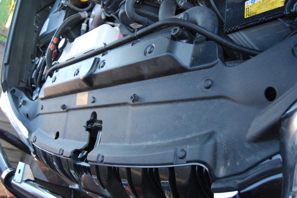

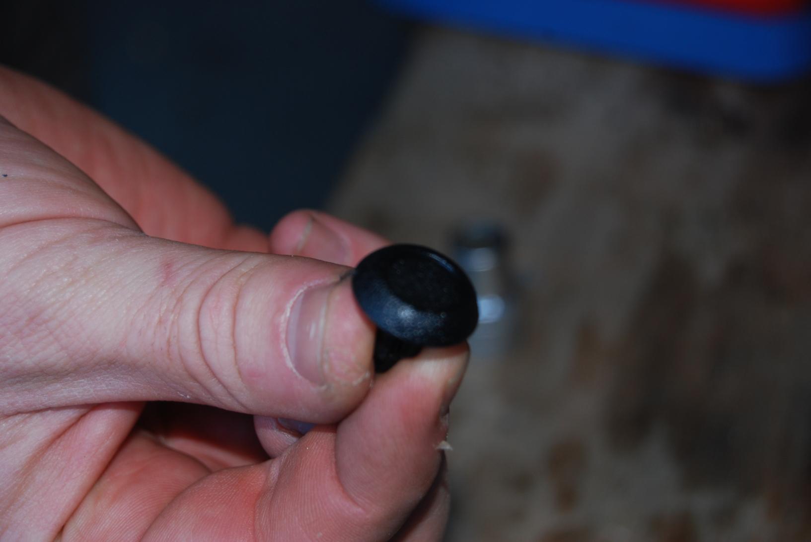

I call them Jesus Clips, they are the plastic tab's that hold the top plastic cover over the radiator on the Prado, there is about 12 of them holding it down...
About 3 - 4 modifications ago, I was sick of using a knife to hold each little tab back as I "release" the center section ready for re-installation.....so after many cuts to my fingers I was thinking there must be an easier way!!

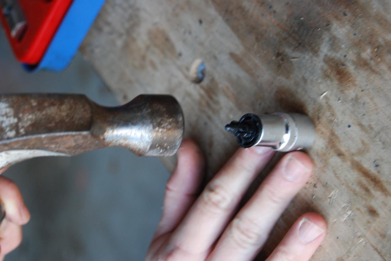

There is, hit them with a hammer!
Place the "Jesus Clip" on a socket that will allow the centre section to drop through, and then just hit it with a hammer lightly. I have done this on my last 3 - 4 mod's where I have had to remove the shroud. Does not seem to cause any damage...
I hope with this post to save some people the frustration of trying to do it "gently"....
