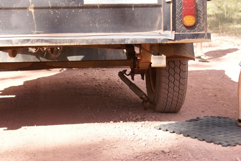

        A mate installed shocks before our Cape York trip and they didn't last the first week.
          From what I've seen the army only use rebound springs on all of their trailers and they pretty much take them everywhere.
          Your mates trailer looks like he has rebound leaves on his springs so as well so that may have contributed.
            Not to mention, the shock looks fine, but the mounting seems to have failed.
            Plenty of campers out there sold with shocks already installed from the factory.
              Have you got a photo of mount that failed, shock looks OK. What was the welding on the bracket like?
