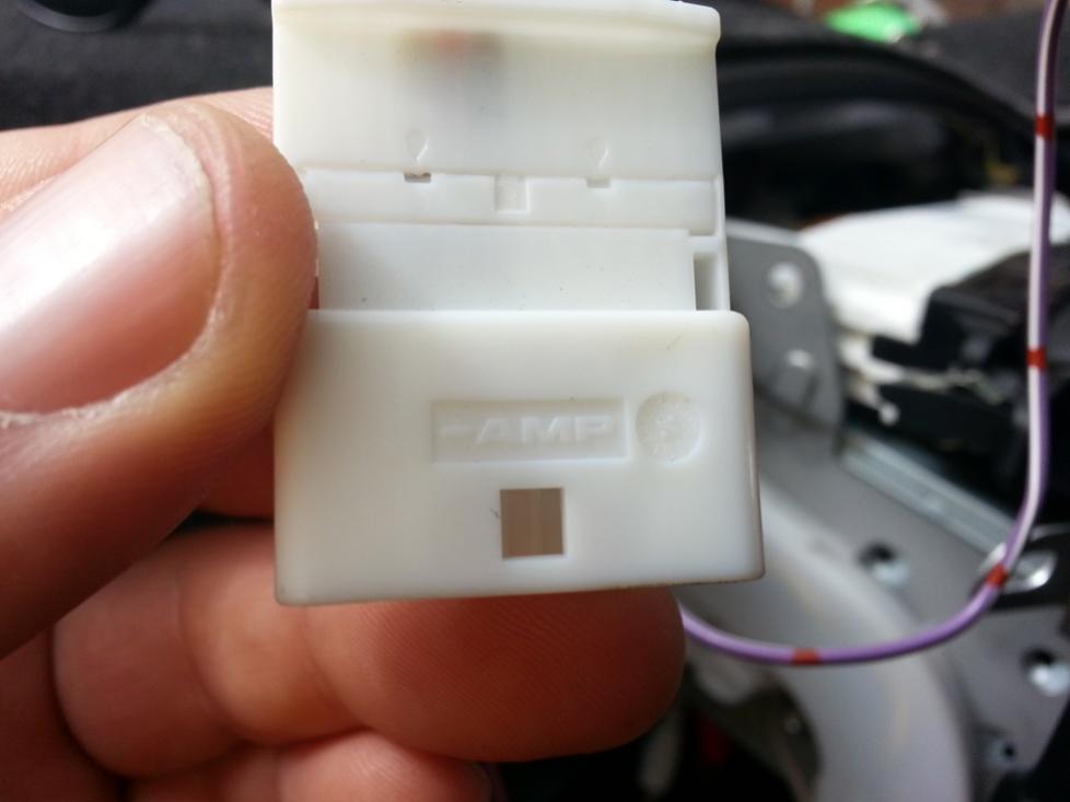

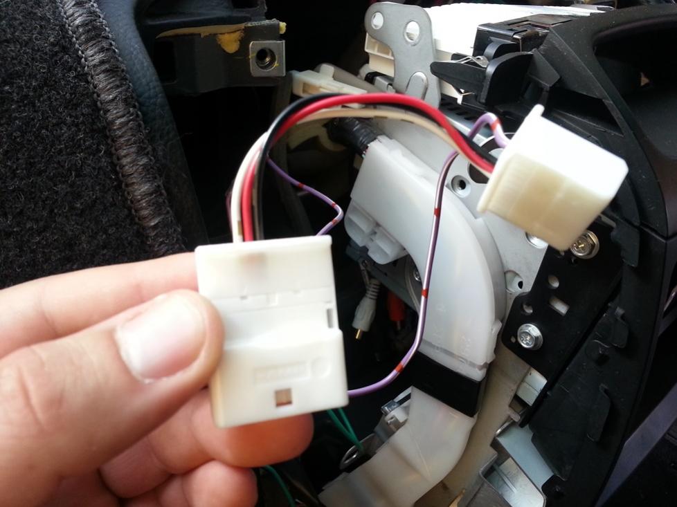

    Hi All,
    I had a dig around behind the stereo and noticed a bridged loom which is two plugs connected together. From one of the plugs is a purple & red coloured wire. I think this is the power wire for the antenna amplifier. The plug is labelled "AMP".Click image for larger version

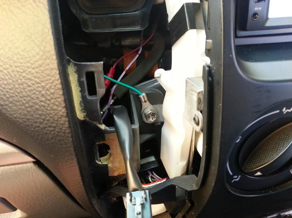

      So essentially, I cut the purple wire and connected it to the 'remote' controller cable on the back of my new stereo. The remote controller wire provides a (+) power signal to an external subwoofer amp to run, I'm sure it is enough power to
      run the antenna amplifier.
      Also, I'm 99.99% sure this is not allowed, but here is where I connected the 'park brake' signal wire. Essentially it is just an earth, to allow the DVD player to run whilst the car is in motion. :lol: I'm sure most of you guys have figured this out already though! (its the green wire with a ring terminal)

                Steve your not a DH. I am! DO NOT CONNECT the purple wire. It is a speed sensor wire which links the gearbox speedo and ECU together and its used for the vehicles bluetooth system and speed sensor. I just collected from car from the dealer after it put the car into limp mode. I learnt the expensive way.

                      Im lucky the Toyota dealer just charged me for the tow truck ($66). As soon as they called me, I knew exactly what was causing the issue - my failed attempt at connecting the antenna amp :lol: The purple wire gets a reading from the speed sensor in the gear box to disable the Bluetooth phone book and settings on the radio whilst the car is moving.
