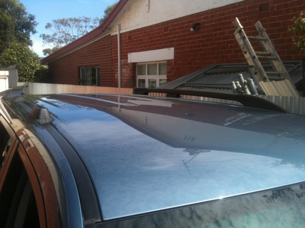

                  With out stating the obvious, you'd need to make the bracket waterproof. You might be able to utilise one of the current roof rack manufacturers mounts. Just as an example the Rhino RLCP23 bracket which is used to mount the pioneer platform onto the 150's, this provides the mounts to the roof, weatherproof shrouds and washers etc plus then you know the height to the top of the 'feet' are all level ready for your awning brackets and mounting screw point provided. Then when you take you awning off put on the supplied covers and all water tight. Hope the all makes sense. You'd have to do more research and way up the cost of the brackets (about $305) but just throwing it out there.
                  On the left the Rhino RLCP23 mount, note the front on looks high due to the slope of the roof line if you zoom in you may be able to see the rear ones, on the right factory rails.
                  Hope this you to create something that works for you.
