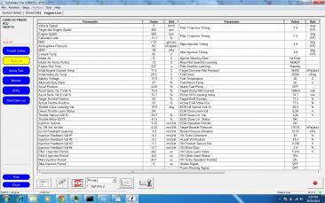

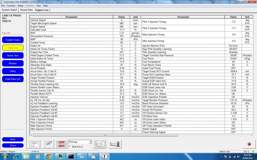

                • Well, my cable arrived in less than 2 weeks from China - took me a week to get around to setting it up though. Win7 x64 setup wasnt the easiest, but got there in the end.
                  Looks like I dont have anything to worry about for the time being.....
                  Cold screenshot (well, as cold as possible - it crashed once I started the car)
                  Warm screenshot
