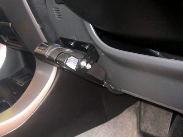

        Below is a pic of where I mounted mine. I am not tall with long legs but I am not short either .
        Plenty of leg room for me.
        David (AKA Grumps)
