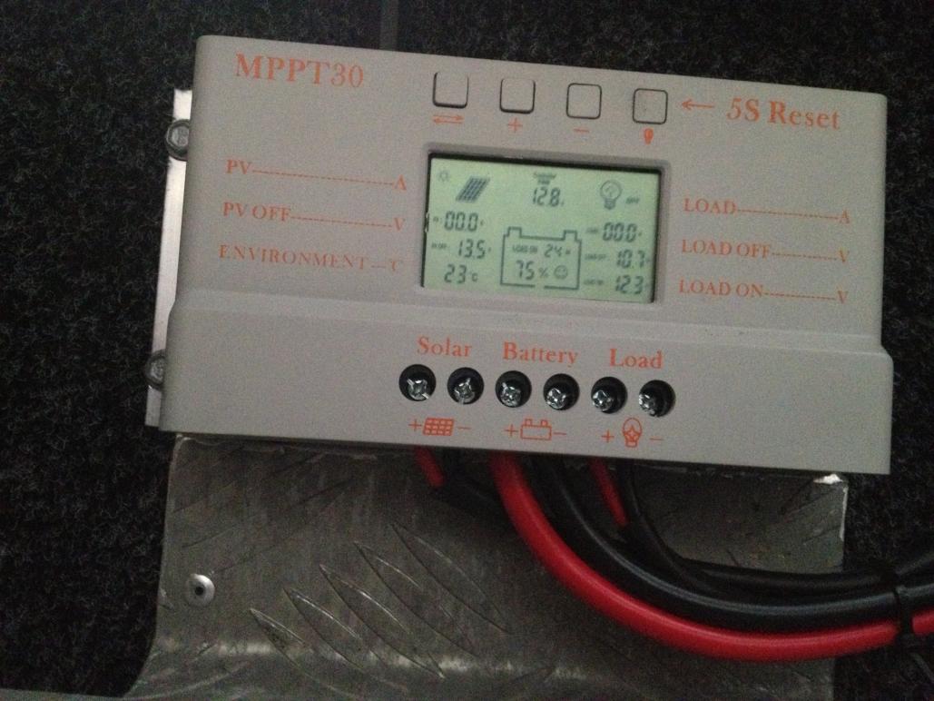

      Weakest point on mine are the support legs. Yours look more stable. Nothing a little modification wont fix though.
        Measurements are right Craig. Here's a pic of mine inside the toolbox on the front of my trailer

          Are you using this in place of the one that came with the fold up panels?

                yes thats right mate I used this regulator in replace of the one that came with the panels. This wasnt the original plan and I used the original regulator on many trips. The only reason I changed is because my panels are now permanently mounted to my camper and are no longer portable. Ive also got the regulator hooked up to three 90 amp hour batteries so this regulator suits my needs a lot more in showing me exactly what is happening with my batteries.
                The beauty of this one is it has bulk float and absorption charging so basically when the batteries are full it will automatically drop solar and only trickle feed, the regulators on the portable kits (ebay ones) do not do this, they will keep pumping voltage in resulting in over charging of the battery constantly.
                They are fine to use for the odd camping trip to keep charge I just wanted something a little better as its a permanent setup on the camper.
