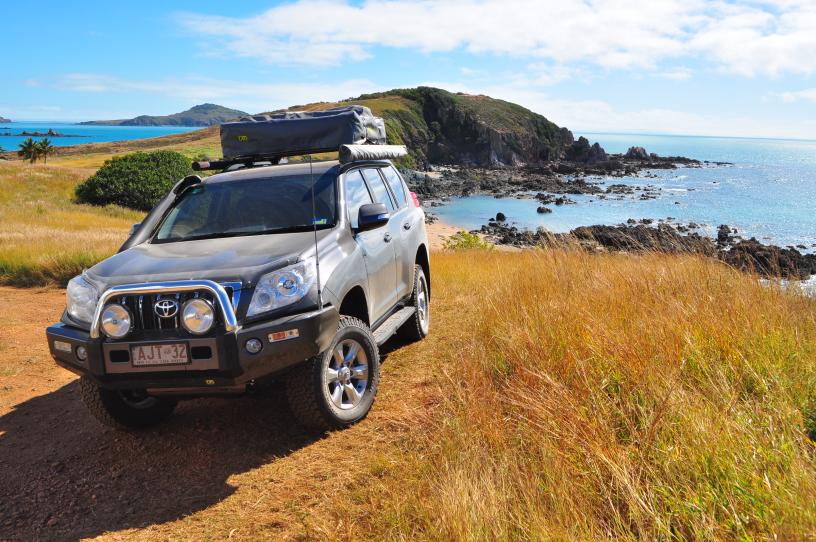

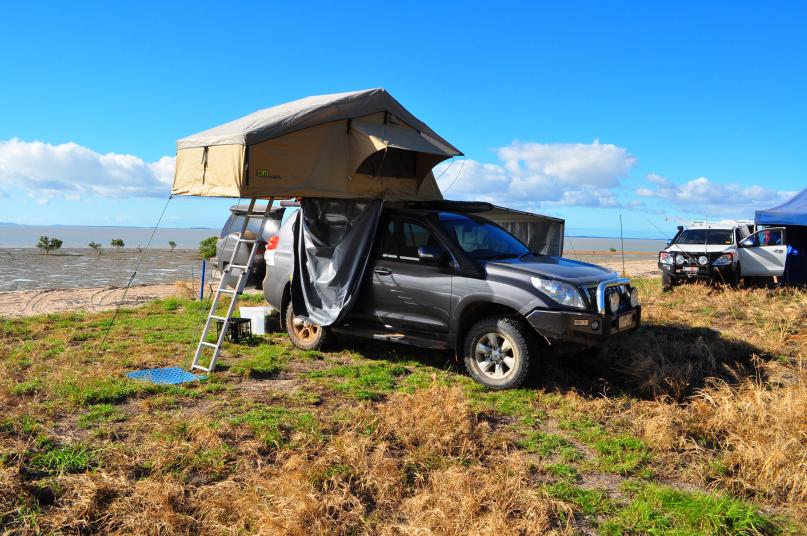

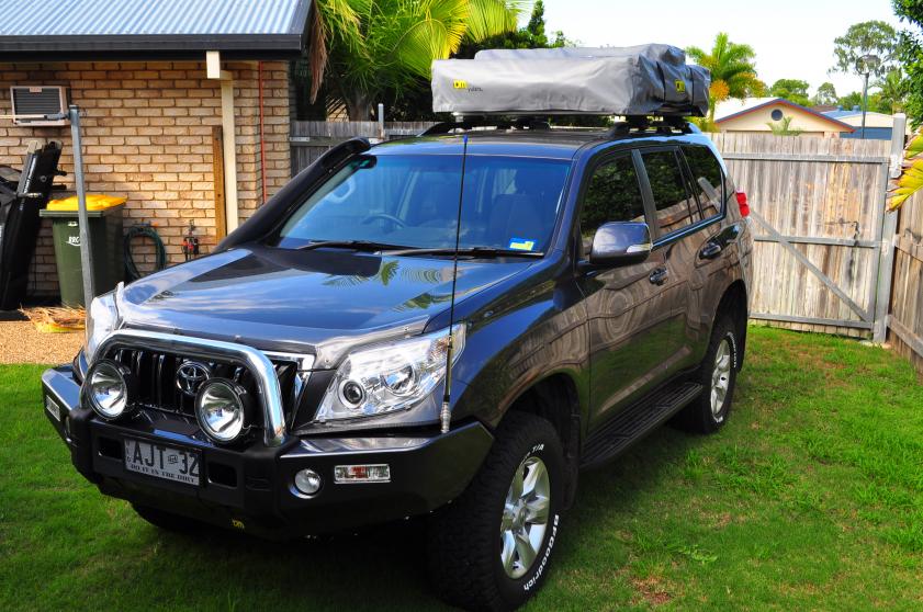

                I put a set of Thule Wingbars on mine and installed the tent to that. Easy, rated in excess of the weight of the tent and only takes about 15 mins to put the tent on or take off. Had them on now for about 10 months and done 8 trips with the tent - Never had any dramas at all and I am 110kg.

                I will put an alloy rooftop tent rack on for our 2014 cape trip though, only because I will need the additional storage space up there, however for short trips I will continue to use the cross racks.
                Also as you can see in the pics, even with just the cross racks, it is still easy to install an awning off the side as well.

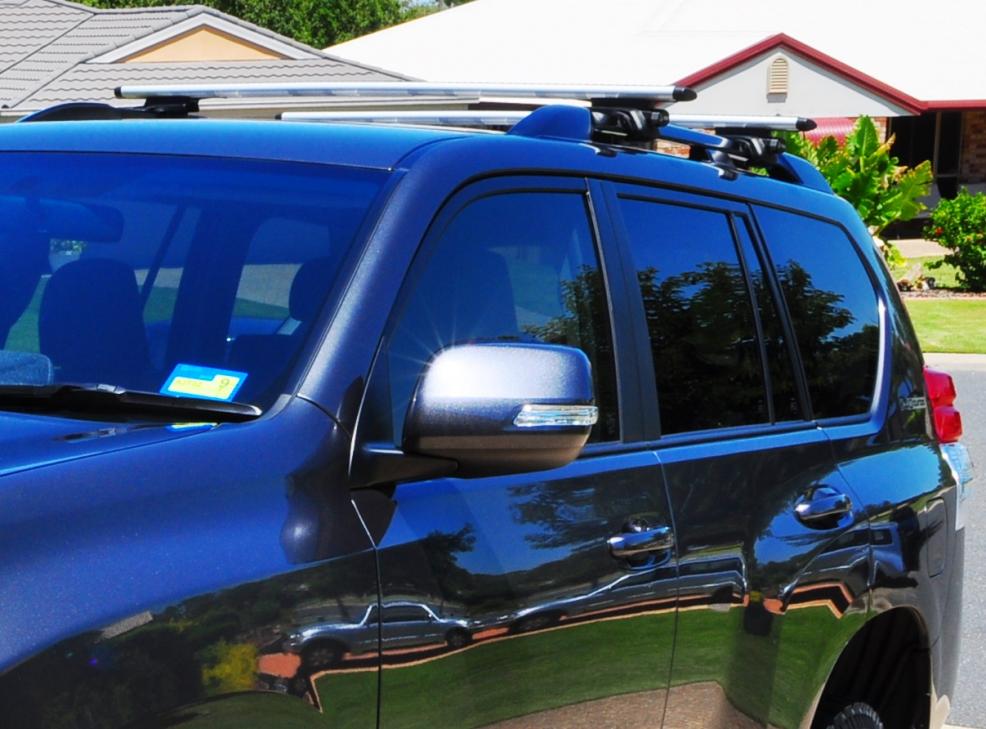

                        No I have the standard Wingbars. I looked at the edge and I reckon they would look great, but I think they would be much more difficult to attach the Awning to. I also carry a rod tube on the driver side and the way the Edge bars are designed, I would have no way of attaching it.
                        You can see the bars better in this pic.
Name:	DSC_2061 - Crop.jpg
                        I ordered Wingbar Pack GL969 and Foot Pack RT757. On the Thule website there is a section called "Fit my Car" - have a look on there for the various options for the Prado.

                          Thanks The Alberto, the pictures on Thule website don't really give you a good idea of what it looks like fitted to the Prado. Your picture confirms for me its exactly what i'm after, both structurally and aesthetically.
