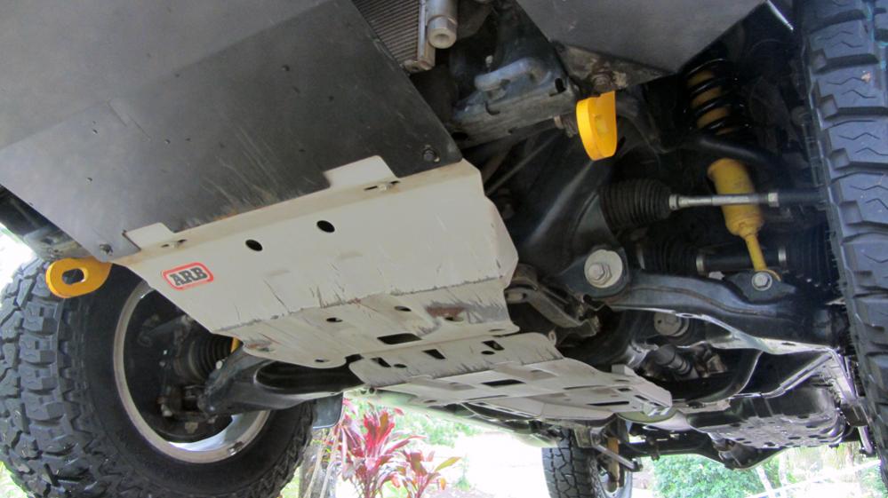

        I can't complain about my ARB bashplates, they have copped a hiding and have done there job well.

          Couldn't agree more, my ARB ones coupled with Brains TG150 has been a great combo, both extremely well priced, built and easy to fit.
