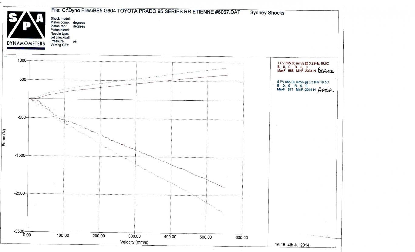

                  They also gave me a print out - does anyone read Suspensionese?
Name:	Bilstein Rear Revalve.jpg
                          [ATTACH=CONFIG]16507[/ATTACH]
                          I worked in QA for Monroe for quite some time. Our performance charts were slightly different than these ones. Looks like you have 300kg at 1/2m/s. So if you wheel was moving up and down at 1/2 a meter a sec it would take 300kg of force to move the wheel. The slower it moves (up and down not around) the less force it takes. So at .1 m/s it only takes 50kg of force. Looks like about a 10kg difference at .1m/s and about 100kg differnace at 1/2ms. There is no starvation of oil in compression. They look fine. But as the guy said they were fine to start with. Just not suitable. Hope this helps.
                            Is the top compression and the bottom rebound?
                            95 3.0 Camp Car, 150 V6 Daily Driver[SIZE=4]
                            [/SIZE]
                              Sorry about the delay I thought I responded to this already. As I said our charts are slightly different. Ours were in a circle with the rebound at the top and the compression at the bottom. Rebound was typically higher than compression so at a guess I would say that on this chart Compression is on the TOP and rebound at the bottom.
