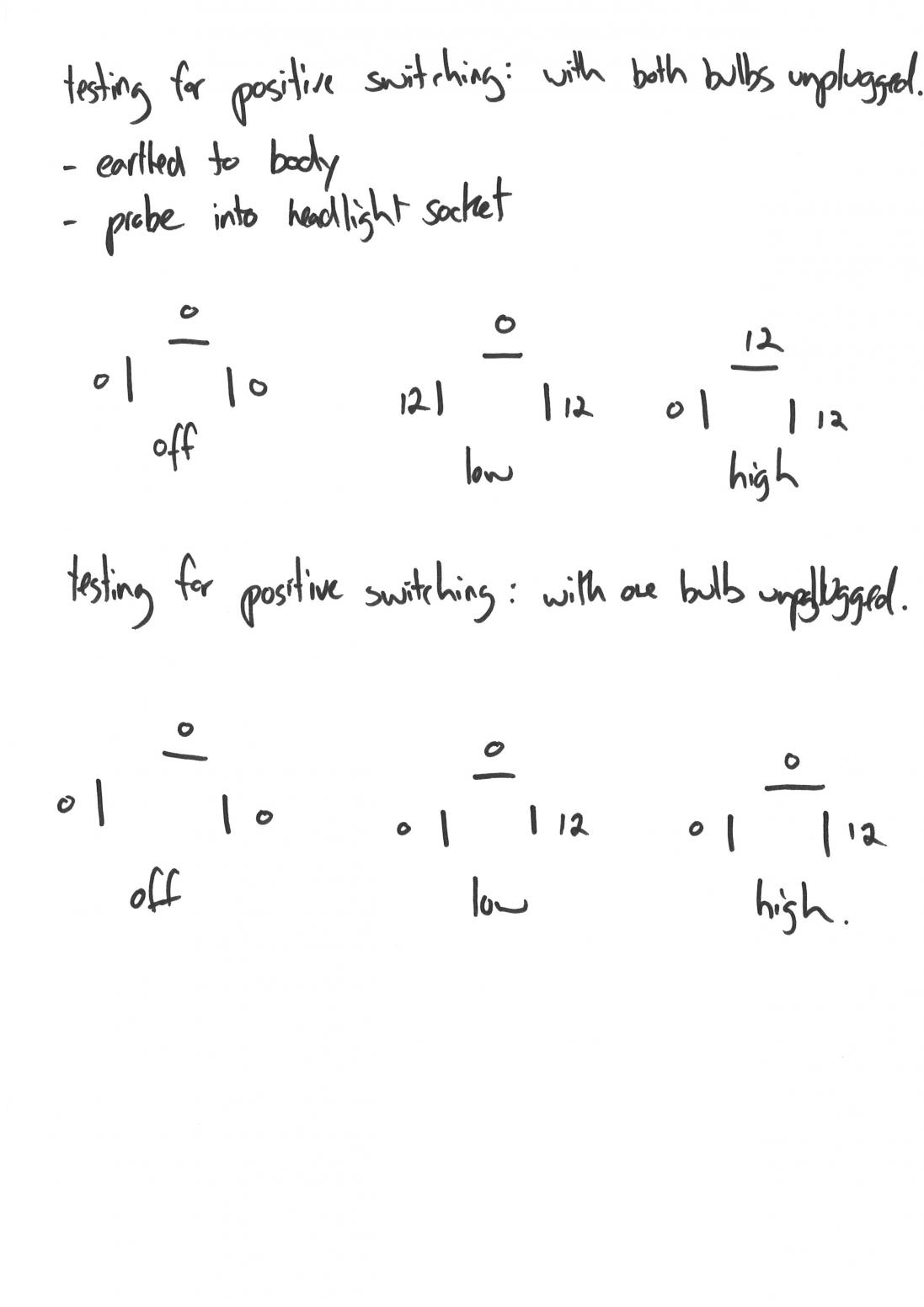

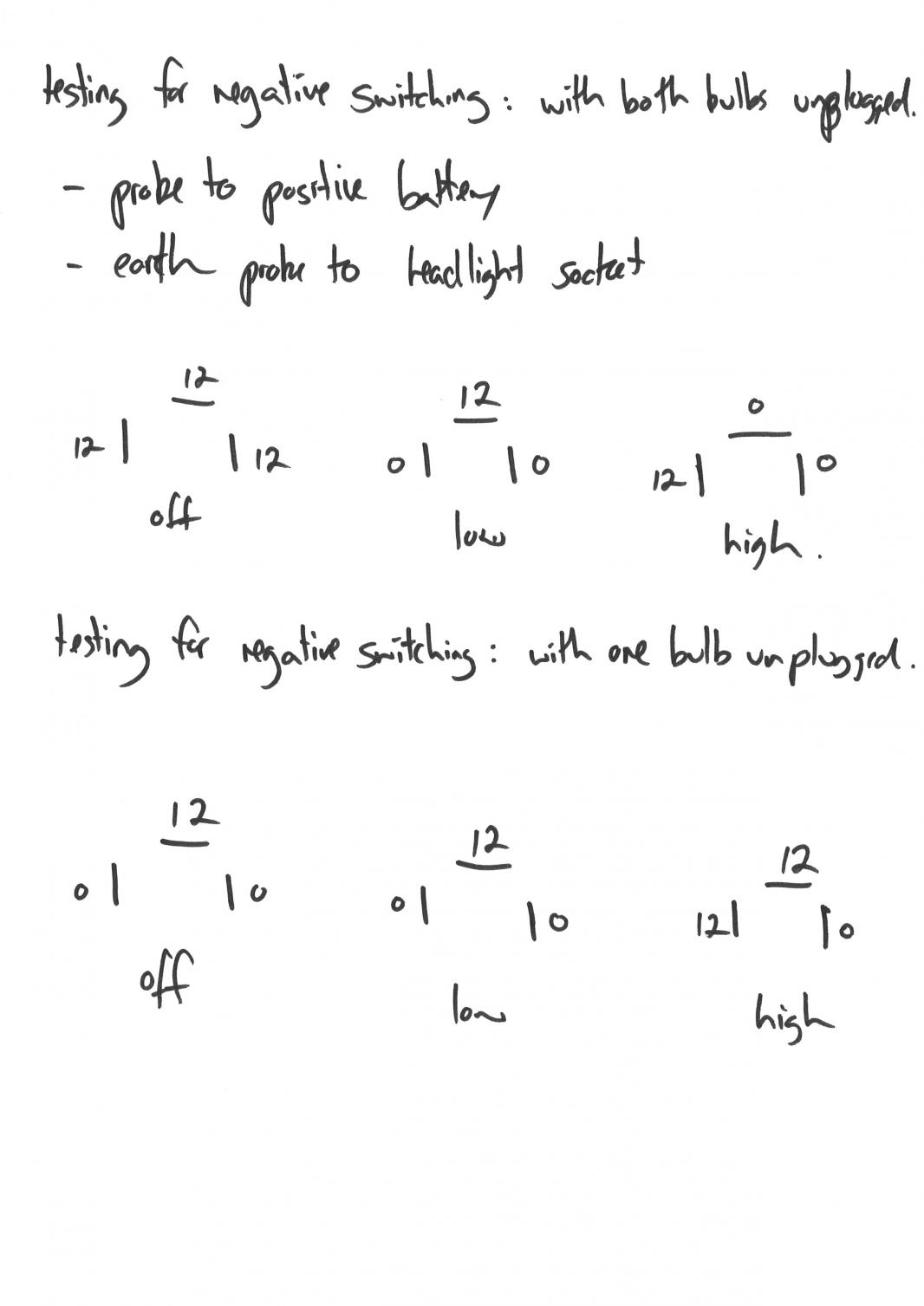

A query for all the electrically minded out there;
After reading every thread on here and many other forums about installing my spotlights, I would like some help with determining if my 95 series prado RV is positively or negatively switched.
I tested in the 2 different ways i read about and tested with the one bulb unplugged and also both bulbs unplugged and got the following readings, hopefully some one can help before i go any further.

From memory the 90 is +12 switched but it was over 12 years ago when I did mine. According to your drawing with the bulb installed you get +12 on the top terminal with high beam on and 0 on low beam and off which is the same as the 150. You should be able to take that +12V and use that to trigger a relay (through and isolation switch) as per the first reply above.My 150 build - http://www.pradopoint.com/showthread.php?27423-A-Random-approach-to-a-Bluestorm-150-GXL-D4D-automatic

From the diagram in the Manual (Page 230 I think), looks like +ve switching to me.
For my recent driving light install (150 Series), I bought a Narva Driving Light harness. I didn't end up using it (the wires felt under-spec'd to me), but it did come with a clever headlight Y-Adapter which allowed me to connect to the highbeam without cutting any wires. I also used the relay and fuse. 150 Series is +ve switched.Prado_The_2nd now on my Third Prado (and 2 Landcruisers before that!)
