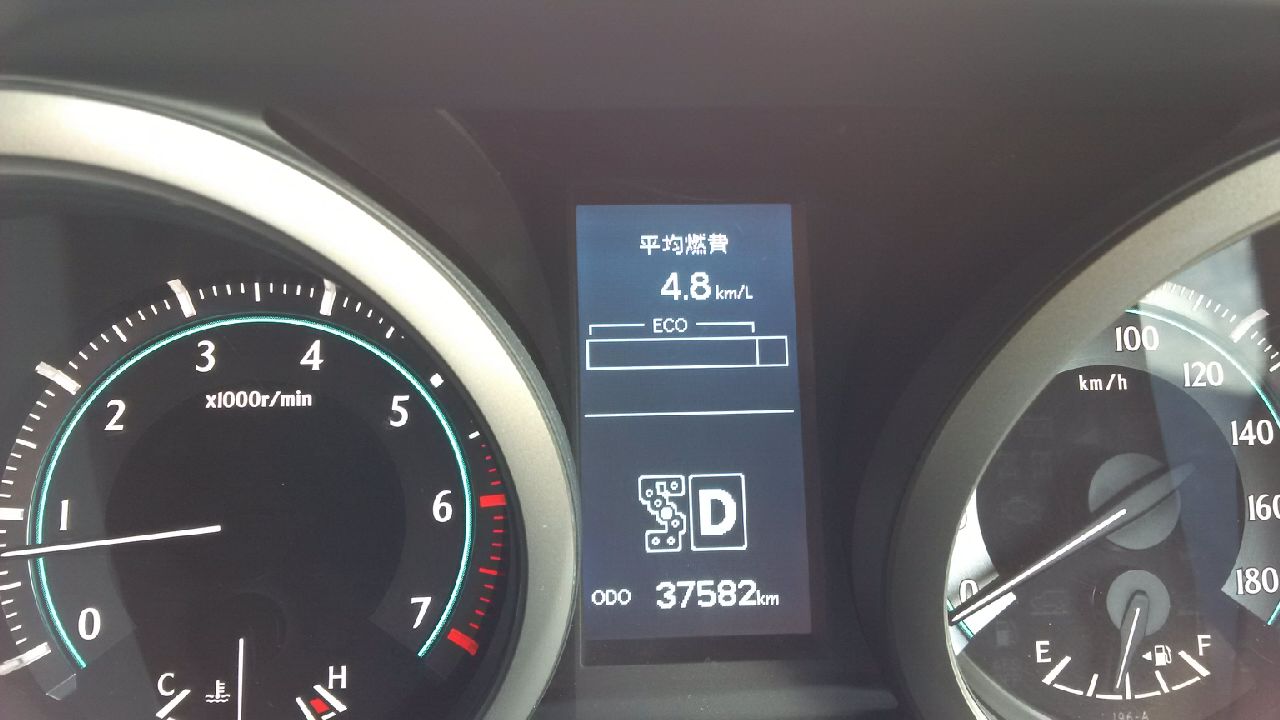

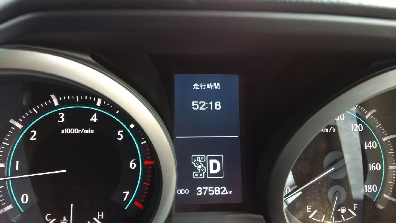

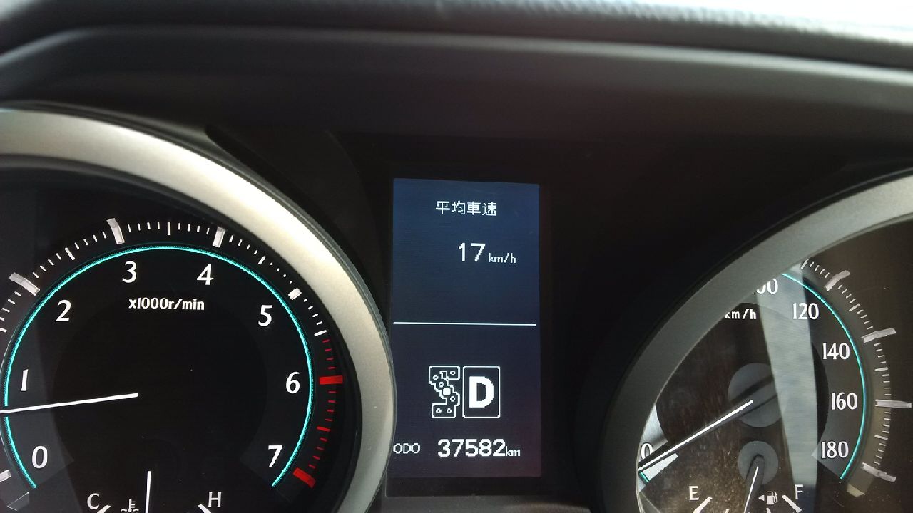

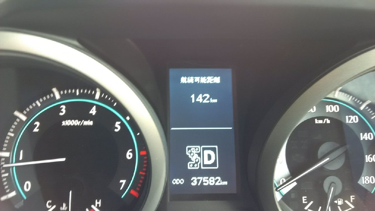

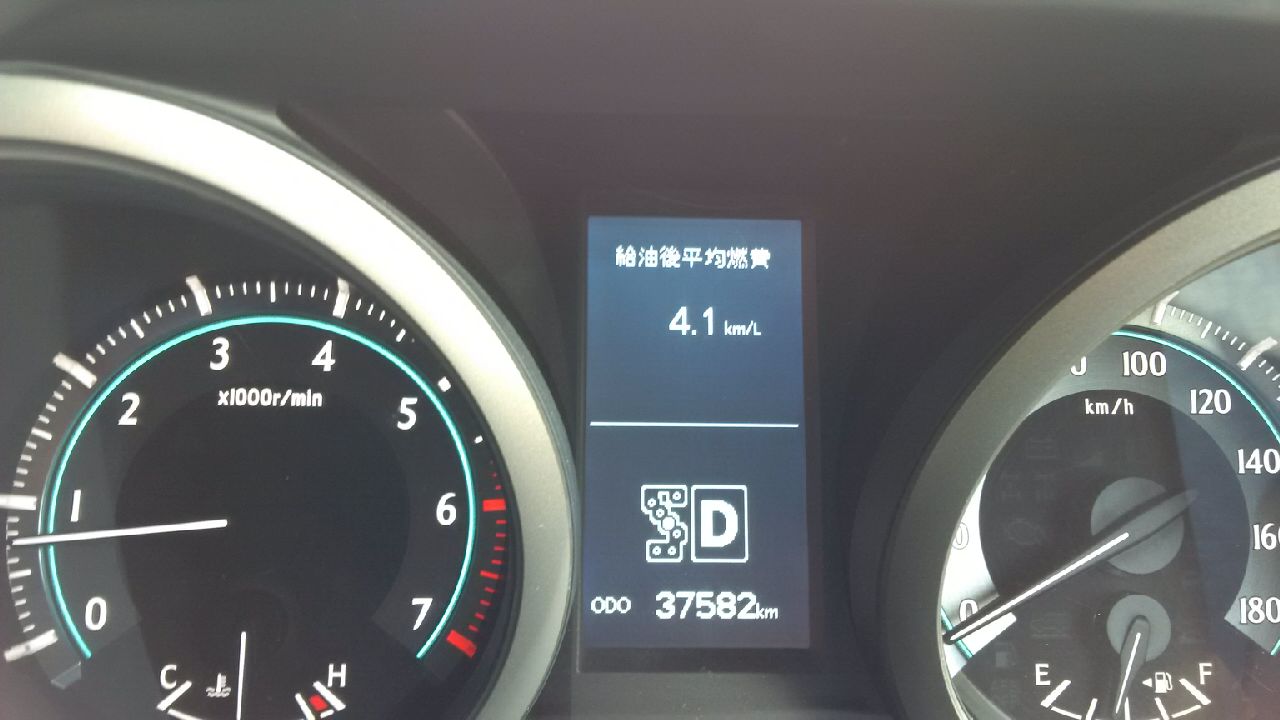

    I bought Prado TRJ 150, 2010 Petrol 2 weeks ago and in my country we get them from Japanese reconditioned so most of the display is still Japanese. I need some help from you to identify which of these means what. Of course some are straight forward, but i copy them anyway so that you can understand the order.
    I'm not expecting anyone one to interpret Japanese I'm only hoping that you can tell me what they are in your opinion because you must be having the English ones.

    No 1 is "Elapsed Time" - displays the elapsed time since the function was last reset (reset by pressing the "enter" switch when average fuel consumption is displayed).
    No 2 is "Current Fuel Consumption" I think but not 100% sure as it looks a bit different to the pic in my manual.
    No 3 is "Average Fuel Consumption" I think but here it's displayed as L/100KM so I can't be sure.
    No 4 is "Cruising Range" and based on the amount of fuel left in your tank and your average fuel consumption - it's only a guide though don't rely on it.
    No 5 is "Average Speed" I think based on the pics in my manual.
