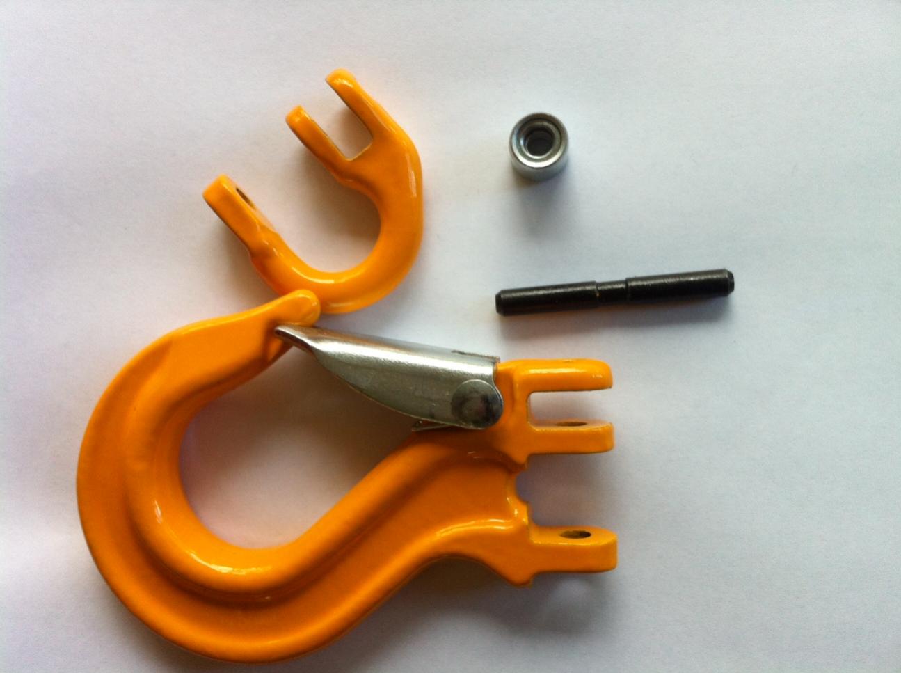

                I recently purchased a Runva 11xp and installed it myself. But I have been unable to attach the hook to the rope because the fittings supplied offer no way of securing the pin to the round nut provided, since the pin is unthreaded. The pin just falls out very easily. Are there any easy solutions to this?

                      It's nothing like that fido666. It just a straight piece of 1/4 inch steel rod with no way to hold it into the hook to stop it slipping out - other than sticky tape. I'm seeking advice from the vendor and Runva agent, but it's hard getting a response.... still waiting.
                        Post up pics. Normally the pin has an area that expands into a recess in the hook. Look at the hole in the hook.
                          Hi alanm , my runva came with a split or cotter pin to prevent the shaft from slipping out

                              I have heard back from the vendor, and he has a solution which looks promising:
                              "The pin needs to be hit in with a hammer. It will only go in from one side of the silver sleeve (the side with the larger opening). 10 second job To remove the pin, it's the opposite (hammer it out with a punch). "
                              You can see these parts in the picture - the rod and the round receiving 'nut' or 'sleeve'
