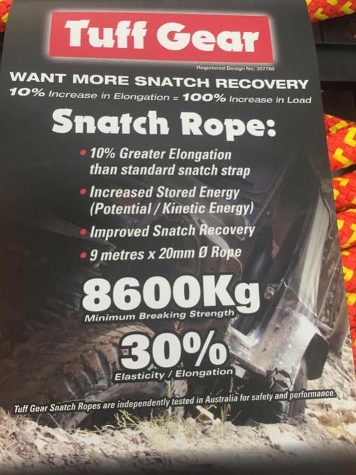

    I stumbled across this on the weekend. About 20mm thick. Seems lighter than snatch straps. Would love to see how those claims hold up...
