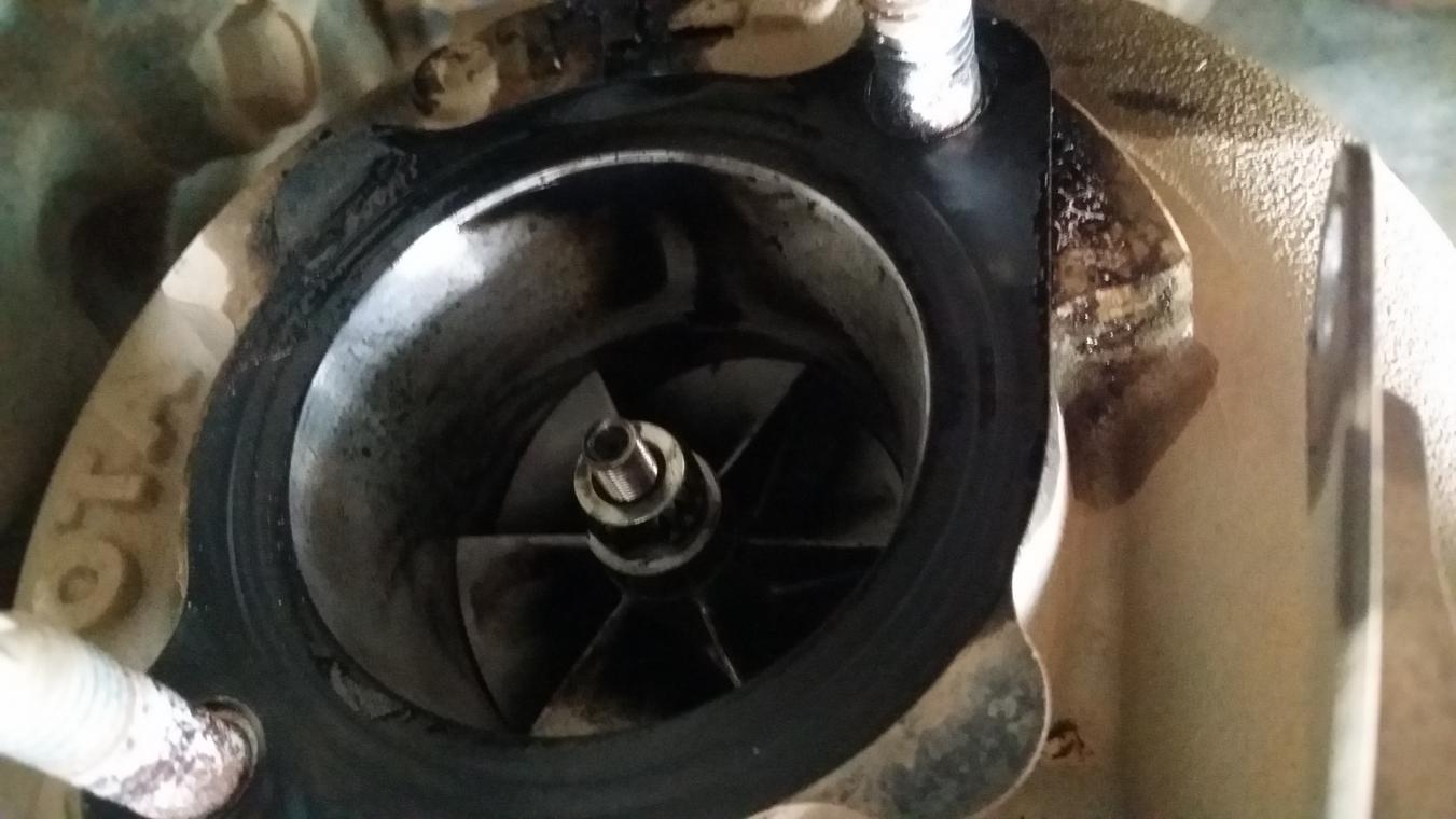

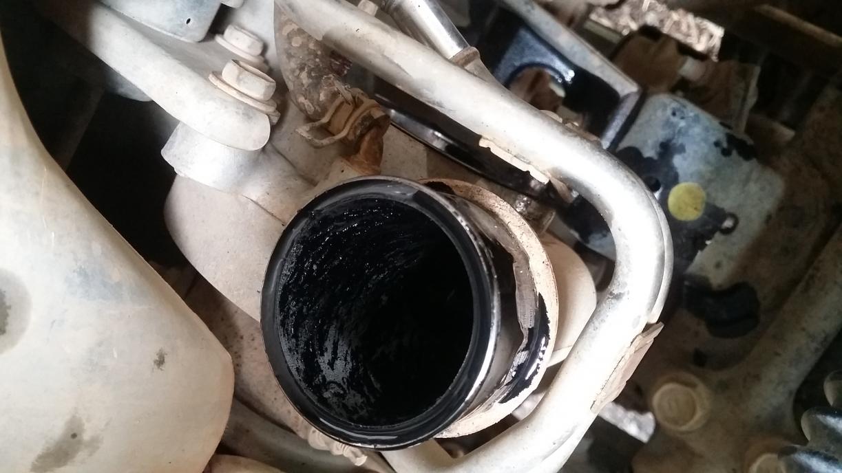

    Today I pull off the cross over pipe and see that it and the turbo have a fair amount of oil in them.. see pic attached, anyway I had been flicking through the posts here and doing what I can to fix the issue,

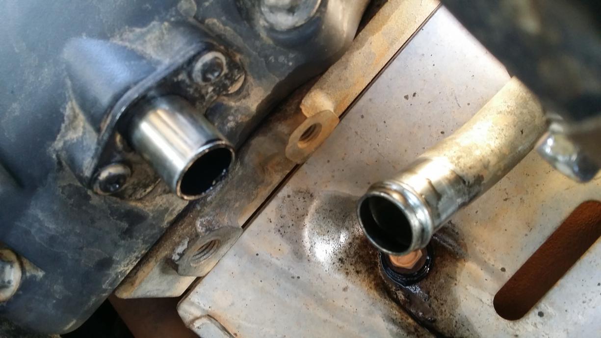

    So I've cleaned the turbo out cross over and throttle body and inlet manifold, remove the breather and see its dripping oil.. hmmm

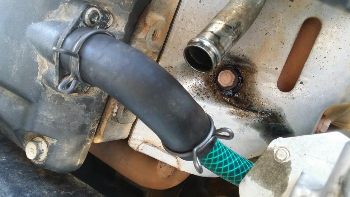

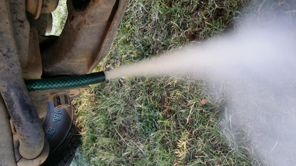

    Long stroy short everything I've done hasn't helped one bit!! So I've re routed the breather outlet to under the car as it just pumps the turbo full of white smoke and oil.
