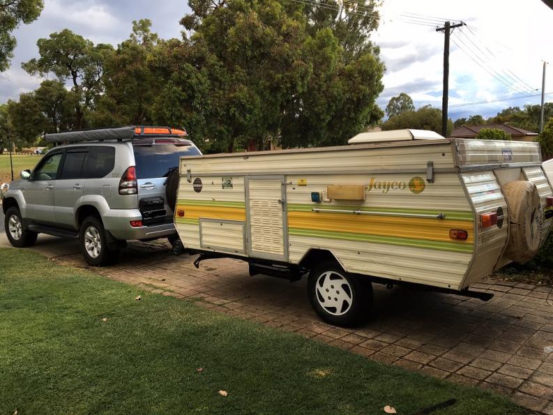

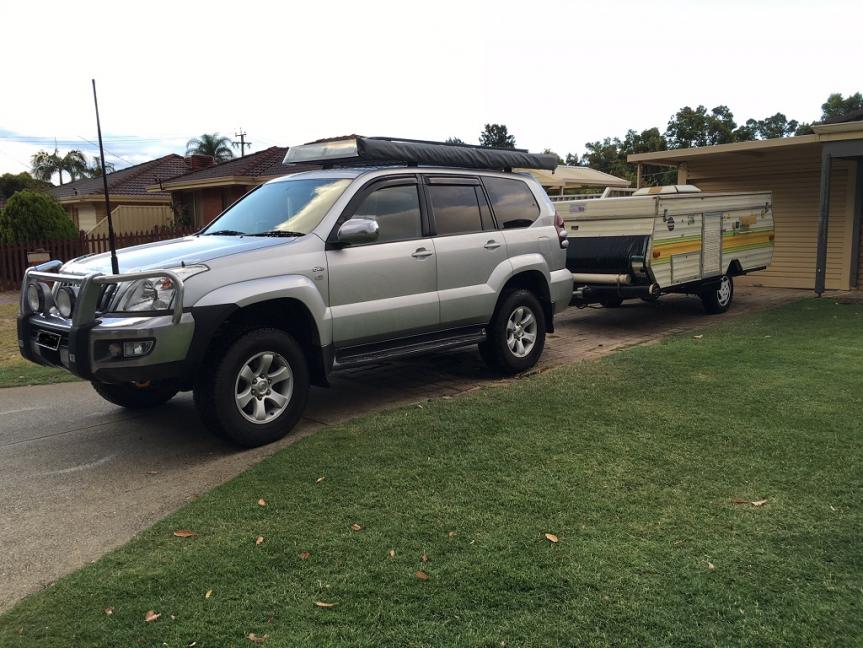

                  Well, we bought it last night. It is the OffRoad model so it already sits a little higher and matches well with the 2" lift plus tyre increase in the Prado.
                  It has Jayco Torsion suspension under it, so it wont be as easy as a axle under swap.
