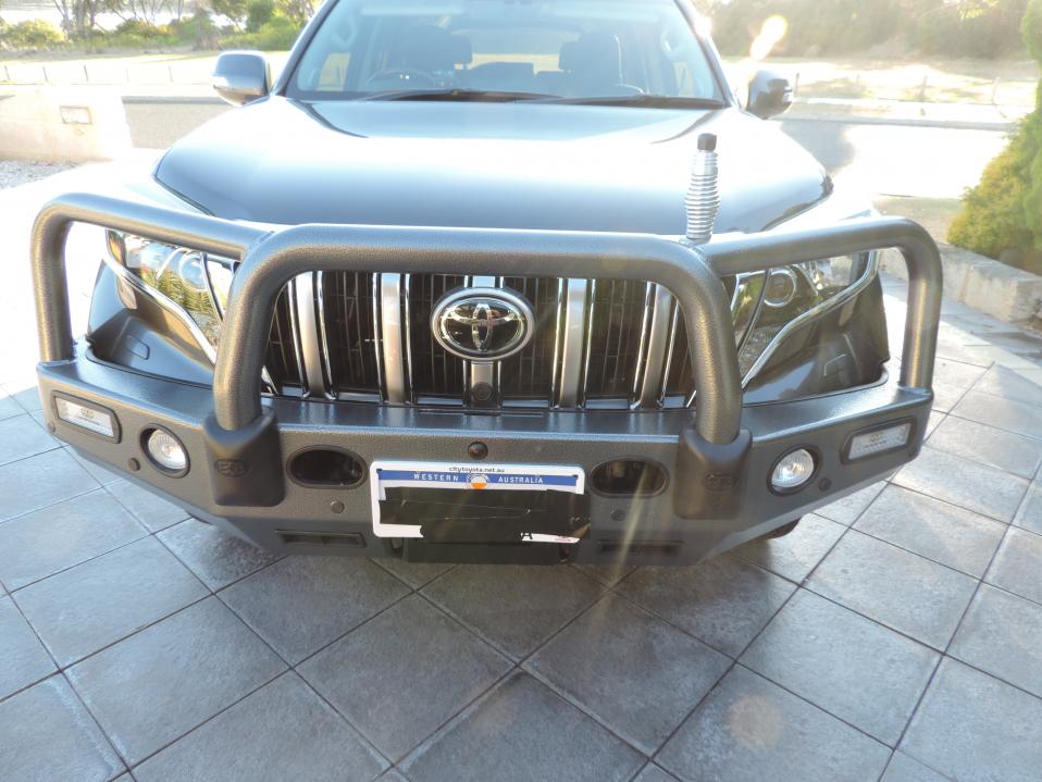

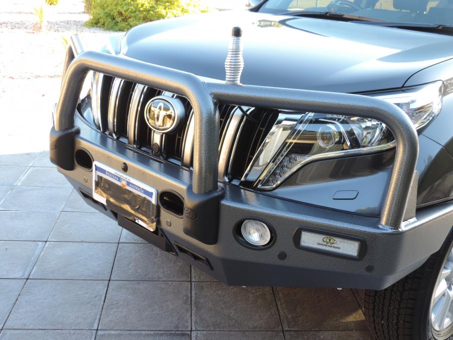

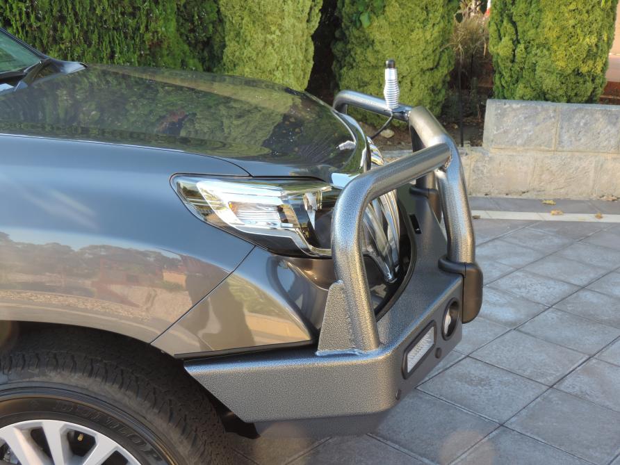

                      Photos as promised. I hope this works!
ID:	653215Click image for larger version
                        Re previous posts, if you look closely at the photos of the bar above,you can see where they have repositioned the front camera on the bar which was really clever and neat. Also you can see where they have moved the misplaced front left and right sensors (the misplacement of these removed the corner sensing capabilities), filled the holes with a neat rubber grommet and then shifted the misplaced sensors to the corners where they should have been in the first place. I will have to go offroad and use the front camera in conjunction with low range and the multi-media system to see if I get the same camera view as before the roo bar was fitted but here's hoping.
