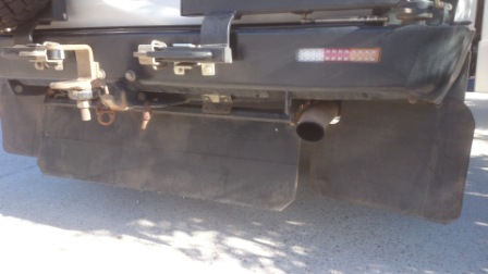

I run a second set of mudflaps about a foot back from the originals made from conveyor belt and bolted to the underside and it's lowered any crap coming out the back to the same height as the "A"frame on the camper. A couple more bits of rubber here and there on the camper and i haven't had any stone blasting in the 5 or so years they've been on there.

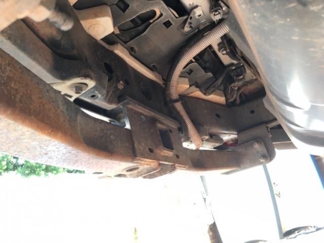

First photos is forward face of my tow bar - you can see how much stone damage there is. Notice the two bolts where it bolts to the chassis bracket - these are the ones I use to hang the new stone stopper off.

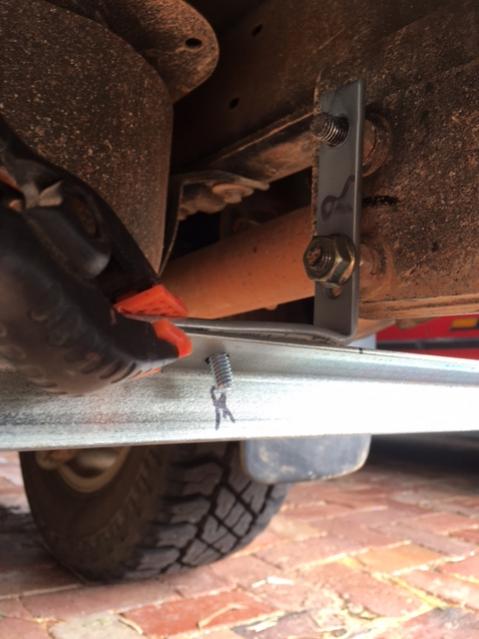

Brackets I made up from Bunnings shelf brackets. I have twisted them so the angle sits about 30 degrees off vertical to help angle the mudguards back so stones are sent downwards.
Plan is the brackets live on the vehicle, and I can take the stone guard on/off by removing 4 bolts. So 5 minutes tops to put on/take off when I go away.

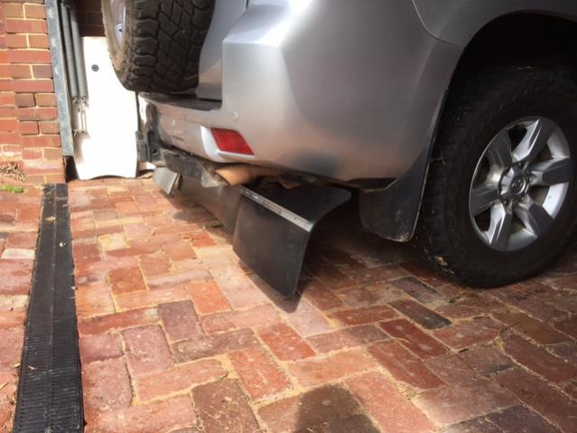

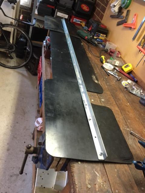

Mudguards made up out of 3 pieces using 4mm 2 ply rubber from Clark Rubber, $125. Cut-outs for exhaust etc. Figured I would use 3 pieces to make it easier to cut/modify and replace if they break. Note this is trial fit only - will all be painted back and will use nylocks for all bolts.
Trial fitting. Note our garage floor slopes up so the photos are deceptive. Gives about 15cm clearance from the ground behind the wheels and 20 cm in the middle. Also note the rubber bends over on the top to protect the underside of the car.
