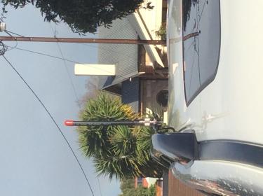

                        Got the short stubby aerial when I recently fitted a gme 3550s. Fitted to oem roof rails on recommendation of Electric Bug in Adelaide. As they said, "height is might", don't need a stick, less dramas and better reception when fitted to roof rail. No issues with vibration. Have a longer wire aerial for longer range out bush if needed.
