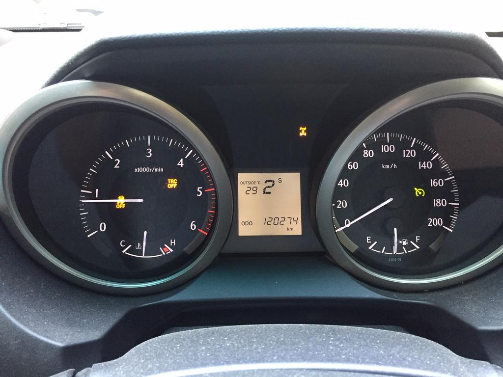

                  This is how my dash looks. One I prepared earlier this afternoon. I dont use low range in soft sand, well not often. Pretty much rely on having appropriate tyre pressures.
                  If you dont have both traction and esc off you will lose power and bog down.

                          Ok, I am lost. With both lights on the D4D at any rate cancels TC and ESC. Maybe someone with a V6 can offer an opinion. This driveline is the same in thev120s with auto, TC and ESC.
