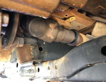

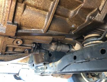

    Hey guys, I have a squeeling noise coming from underneath my 2009 150 series around the transfer case area. Seems to have gotten louder over the last couple of months. Got under there to have a look and noticed this leak in the attached photos. The transfer case looks a bit oily, not sure if that’s from the leak or something different? Any ideas or suggestions what the leak is or noise?

    A common squeal under the 150's is the exhaust gasket underneath the drivers side area which is tightened down on springs. Spray a bit of WD40 on it and possibly the rubber exhaust hangers and see if the squeal stops.
      Could be the rear main seal, leaking into the bellhousing then draining from the bottom of bellhousing and getting spead everywhere by the wind.

        Awesome thanks for the tip, that's exactly what it was!
          hopefully it isn't that, sounds expensive to get to. Will keep an eye on it
