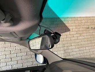

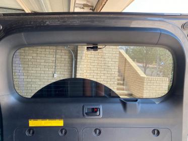

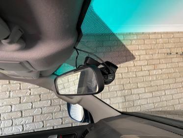

    I did just that a couple of weeks back. I removed the internal door trim and ran it around the inside of the rear door with all the other electrics/washer tubing and back through the wiring grommet/tube thingy then up the rear pillar and across the roof line (top of the doors) of the car to the front camera. I will try and get some pictures tomorrow.

    Front camera with where the cables go up into the headlining and across to the drivers side door. Power goes down the A pillar to fuse box. Rear video cable runs down the roof lining to the rear cargo pillar where it goes down to the rubber cable thingy and into the rear door. Cable come back up behind all the trim to the rear camera. The sides and top pull off and the bottom section has two screws to remove.
