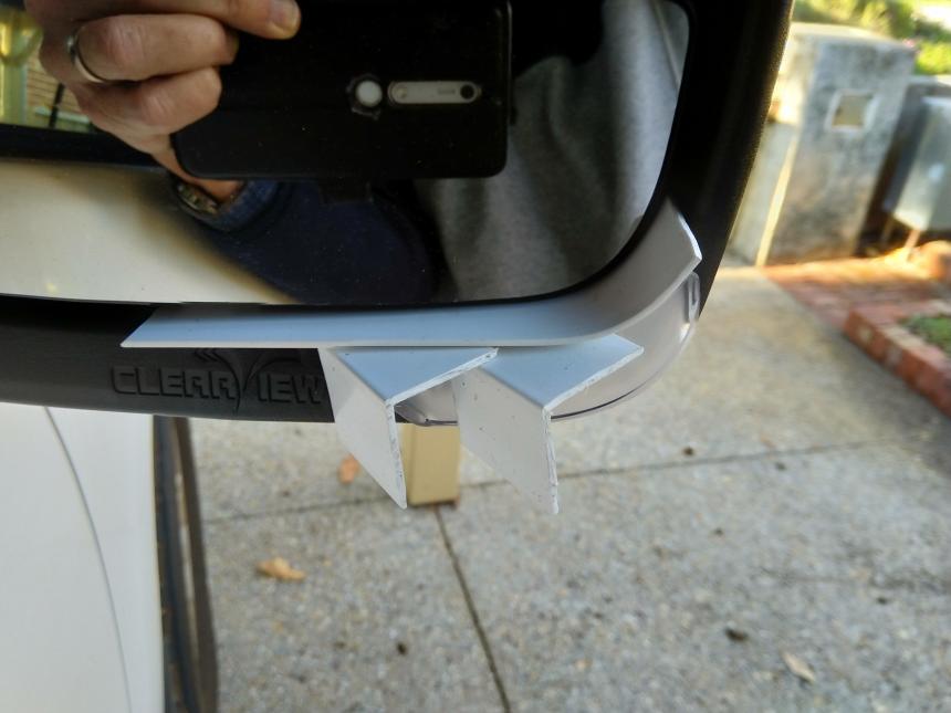

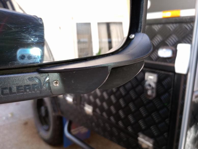

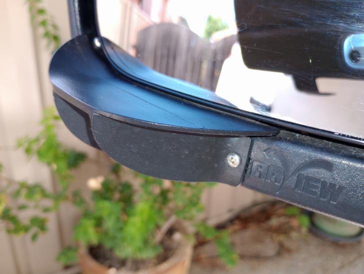

            The blinkers were fabricated from PVC Angle from Bunnings. Brutus 25 x 25 x 2.5mm x 2.4m Angle Building Moulding - Bunnings Australia They can be made with a bit of patience and the use of fairly common tools. I used a fine blade in a hacksaw and a craft knife for cutting. A 150mm fine file or fine sand paper for smoothing curves and edges. Heat gun for moulding curves and bends and PVC cement with small clamps for gluing. For finishing I used plastic pimer because I had some from a past bumper repair and flat black (both were spray cans). Secured with 4G stainless steel screws.
            Here are a couple more images. I cut the angle to make two flat pieces for each mirror, glued together to make a ~50mm strip - you can see the join in the finished image below. The unpainted one was a concept prototype just pushed into the gap to confirm that the idea was going to work.

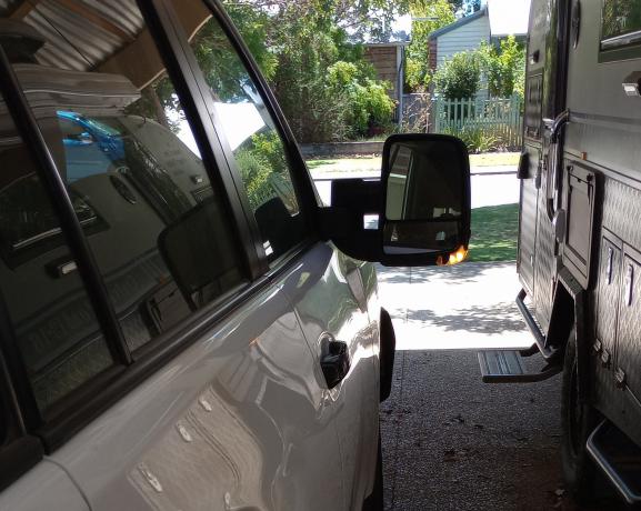

                Regardless, I took the legal requirement seriously when designing my 'blinkers', otherwise I could have just disconnected the indicator wire on each mirror. I've attached an along-the-body-from-behind photo with the indicator flashing - I'm sure it complies.

                  Unless one has had a GVM upgrade over 3500 kg there is no ADR requirement to for side indicators to be visible along the side of the vehicle from the rear.
                  One only has to look at the standard mirror mounted indicators which face forward.
                  Lee
