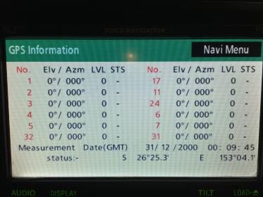

    Recently the gps lost its way and wasn't even pointing in the right direction. Eventually recalibrated and now seems ok. Went into the diagnostic menu and it doesn't seem to be reporting the right info, even though it's navigating ok.
    Here's the screen shot.
    The coordinates put me near Noosa, though I'm in brissie. Disconnected the battery and put me in the northern hemisphere. Still navigating ok though.
    What do others see when displaying the same screen? (Hold down the Info button, same time switch parking lights on off 3 times - see http://www.lcool.org/technical/120_s...av/satnav.html )

    Notice the GPS indicator was missing from the front screen, indicating no signal. Had my dash replaced by dealer recently. Suspect something not plugged back in.
    2006 Grande 4.0L V6, Silver, Sovereign bullbar, Superwinch, Autocraft 2inch lift, Roolights, Dual Batteries
      Either it wasn't plugged back in or it got lost with the old dash.
        Dealer has plugged the antenna back in
