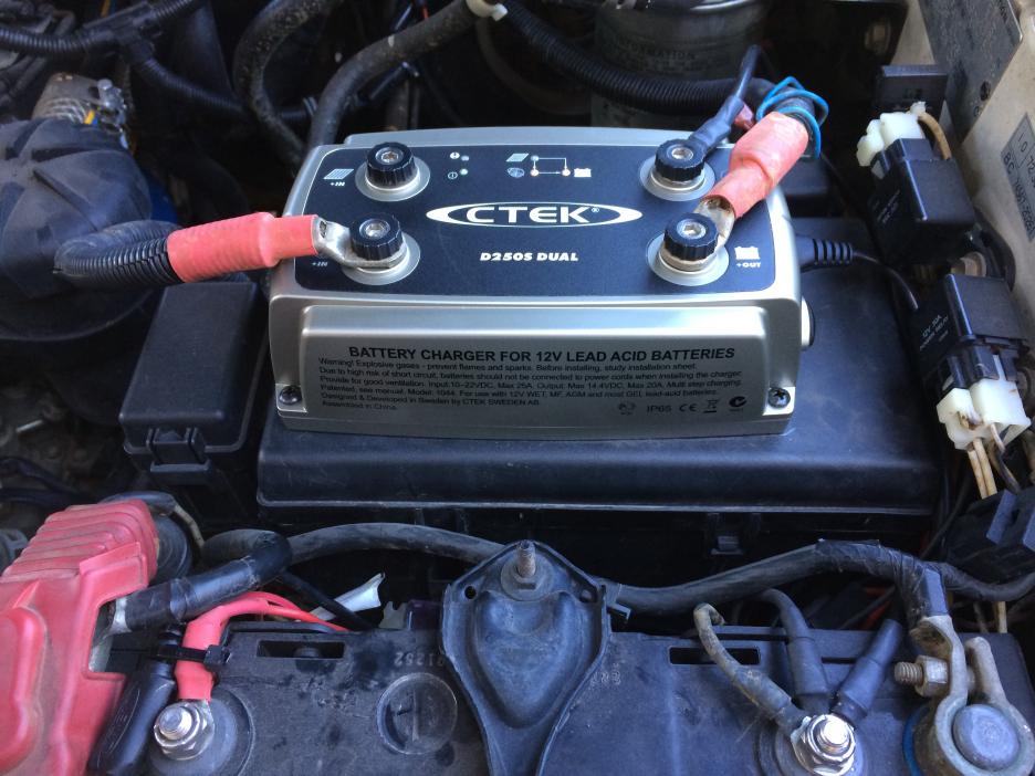

      • So I finally pulled my finger out and installed the DC to DC charger today.. Only had it sitting on the shelf for a couple of months LOL
        Need to extend the battery cable for the 2nd battery but for the moment it's all go! Looks trick under the hood to. Will see how it holds up to the dust and water now. Later on ill wire up a solar panel to.

        • Put a 40w solar panel on order last week to hook up to the DC to DC and had to replace my 2nd battery again as it had dropped a cell or two (under warranty), so ill be able to keep it charged a bit more consistently with the fridge running as it will be a permanent feature on the roof rack.
          • Please let us know how you go with the 40w pannel.
            I was told I would need atleast 80w to get enough power to open the CTEK.
            (ps. set my solar input up with green anderson plugs so no-one could plug into the 12v output which uses std grey andersons... (they are keyed differently so different colours can not be plugged together)

              Hmmm, that's interesting. The CTEK doesn't say anything in the manual about what it needs to be switched? I've got a 20W panel here already so I might even hook that in today before work and see if it does anything.

                    • Oh and by the way... I installed the Solar Panel the other day. And it certainly does switch the CTEK snewby. One thing I didn't know though, was that with this type of controller/charger I had to change my winch power to the main battery as the CTEK will not let enough power go to the 2nd battery under load under the 1st reaches a certain state of charge which will result in it running down over longer periods. The older redarc solenoid type simply switches across once it receives a certain voltage.
