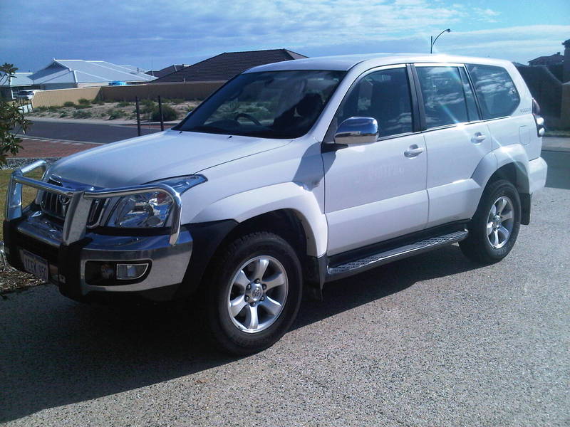

    Thought I'd start one of my own. I've currently only got a photo of the Prad's when I got it but have already done some mods, just haven't got round to taking some new pics. Got ARB to install OME sports suspension (the works) giving me a 2" lift and also IPF 900 EXTREME spot lights.
    2 Weeks time I'm getting the stereo head unit and speakers replaced.
    New head unit: Clarion NX501
    Speakers front doors: 6x9 Alpine Type R's
    Speakers Rear doors: 6" Alpine Type R's
    Extra's: Alpine AMP and Reverse CAM
    FUTURE MODS
    Tracklander Roof rack
    IPF 900 EXTREME spot lights x4 (Attached to roof rack)
    Safari snorkel
    Raised DIFF breathers
    Bash plate
    275/70 R17 Mickey Thompson's STZ
    Stock R17 7.5 alloy rims powder coated BLACK

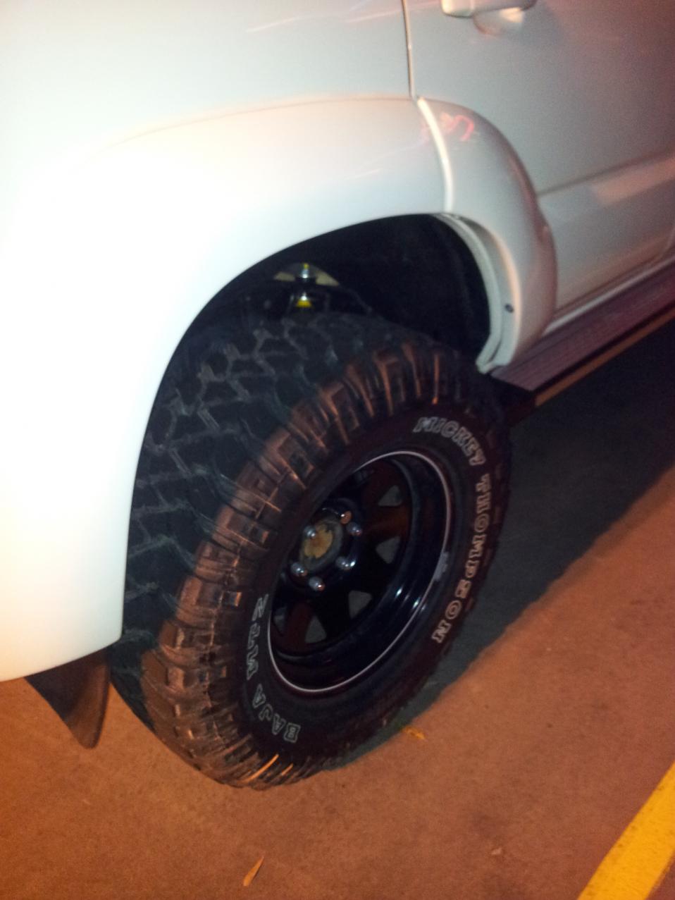

                              285/70
                              I saw a 120 Series Prado running 285/70 the other day at the shops and I've always wanted to know, for me to get 285/70 wheels what would I have to get done so they don't rub on the UCA, at full lock and under compression? Another question would be the preferred size rim which best suits and not having to worry about coming of the rim. I've got 265/65 R17 at the moment + 2" lift.
                              Would love to talk to the guy who's car that was . . .
                              Here's a picture of his wheels.
