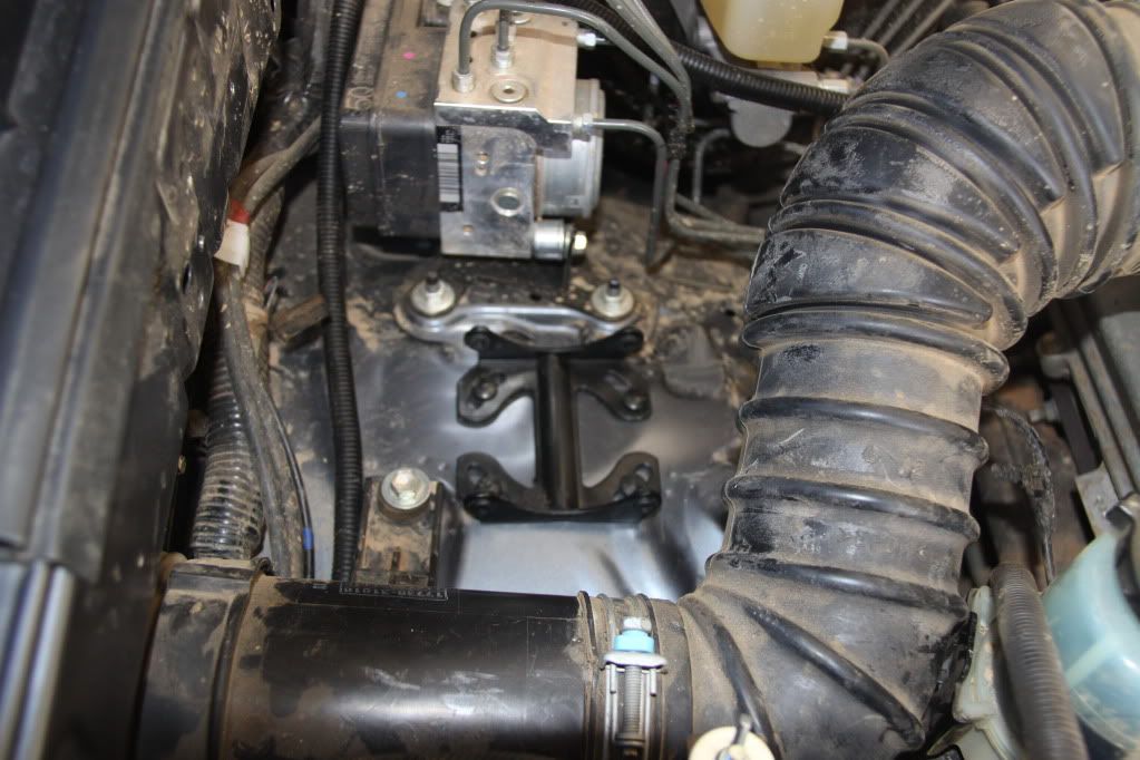

                  Finally got round to a few more mods. Mounted my old ARB Air compressor under the bonnet near the ABS on the driver's wheel arch.
                  Not much room, but it just fits with North-South <1cm of space at each end.
                  Used all the existing mounts it came with and bolted it into the arch with a backing plate on the underside. Wrapped all the wiring in the engine bay in conduit & mounted the relay high on the side near my existing fuse box. Ditched the inline fuse in favour of using the fuse box too.
                  Sent the cables into the driver's foot well through the large grommet. Removed the kick panel & the lower panel under the steering column.

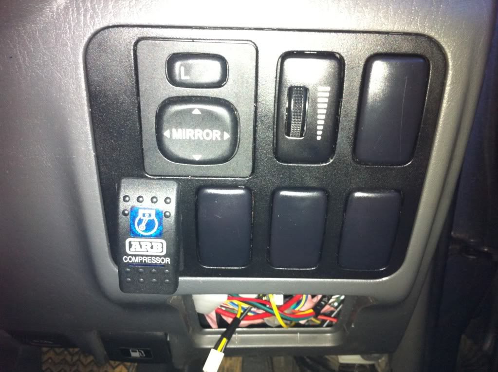

                    Pulled off all of the dash whilst I was there as well as I had to do a couple more things under there next!
                    3 bolts on the drivers cover in the end- bottom right, bottom left and one just to the right of the ignition barrel under a plastic trim piece. Eventually got it off and unplugged everything.
                    Routed the cables up and into the fuse box so that I could put the switch next to the existing dimmer switch on the plate there.
                    A bit of scraping & melting of the switch mount at the back widens it enough for the Carling switch to sit in there nicely.
                    Just had to be careful not to damage the front facia. Looks OK in the end!

                      Whilst I was running those cables through the firewall, I thought I would send back the yellow wire for my IPF spotties that will be going on later. You can see the end plug for it hanging out in the above photo. I intend to cut that plug & wire them into a Carling style 'Bunny Burner' switch.
                      Then I 'conduited' & routed the whole wiring loom in the engine bay ready to go and mounted the relay near my fuse box.
                      Will be plug & play once the bar goes on and the lights are mounted.
